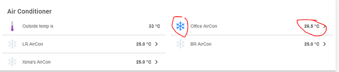

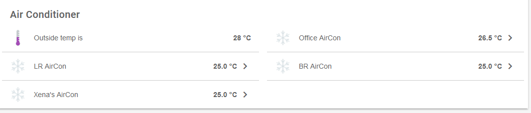

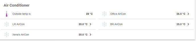

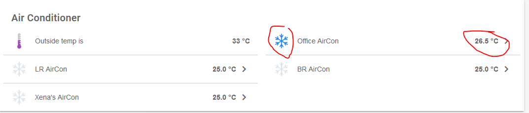

I was on my phone before but now I’m able to post a screenshot:
You can see it shows inside temperatures at a glance, and for more controls one can enter the section. But at a glance I can’t see if any aircon is on.
