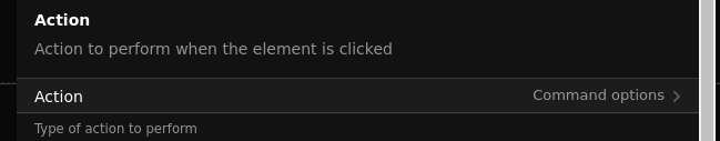

you can configure them for label cards:
and for items as metadata:
not sure what the difference between item command options and state description → options is

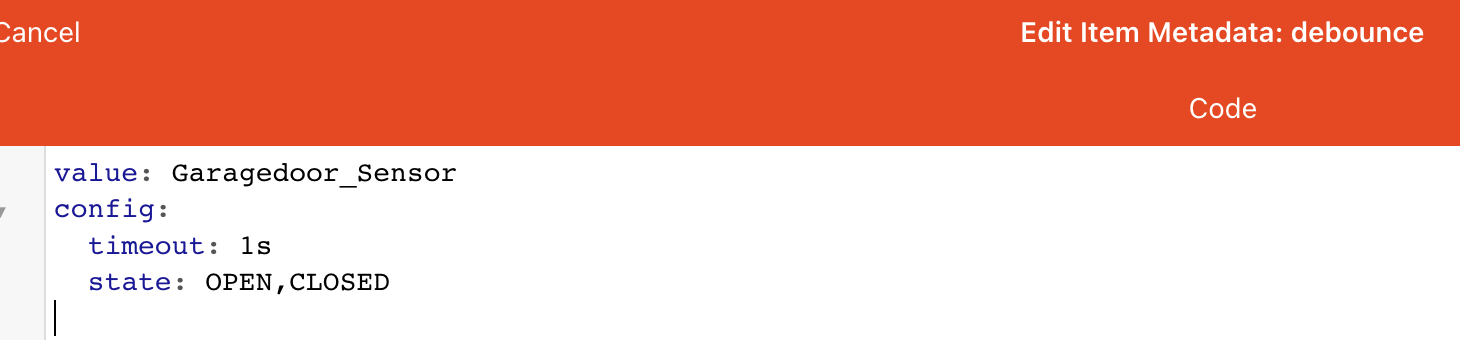

In general, if you see something in MainUI and you want to represent it in a text based config I recommend the following:
  1. Do it in the UI first.
  2. Click on the “Code” tab. You’ll see a YAML representation of your metadata.
  3. Use the following simple rules to translate from the YAML to .items files syntax:
First an example:
Metadata goes between the { } of the Item. Different metadata is separated by a comma (in your example above you have a “channel” and a “stateDescription” separated by a comma.
  • The first value is the namespace of the metadata. In my screenshot example it’s “debounce” (look at the orange part at the top where is says “Edit Item Metadata: debounce”.
  • After the namespace will always be an =.
  • Next you have the value which is put in quotes immediately after the =. If there is no value, use an empty string "".
  • Then you have an array of additional name/value pairs. An array is defined by [ ]. This is called the “config”. If there is no config you can omit this part or add an empty [].
    • each entry will be name="value" format
    • if there is more than one entry they are separated by a comma.
Given these rules, the above screen shot example would translate to:
debounce="Garagedoor_Sensor"[timeout="1s", state="OPEN,CLOSED"]
These rules apply to all Item metadata, whether it’s so called “well known” metadata like state description, Alexa, or Google Assistant, as well as custom metadata you might define yourself.
