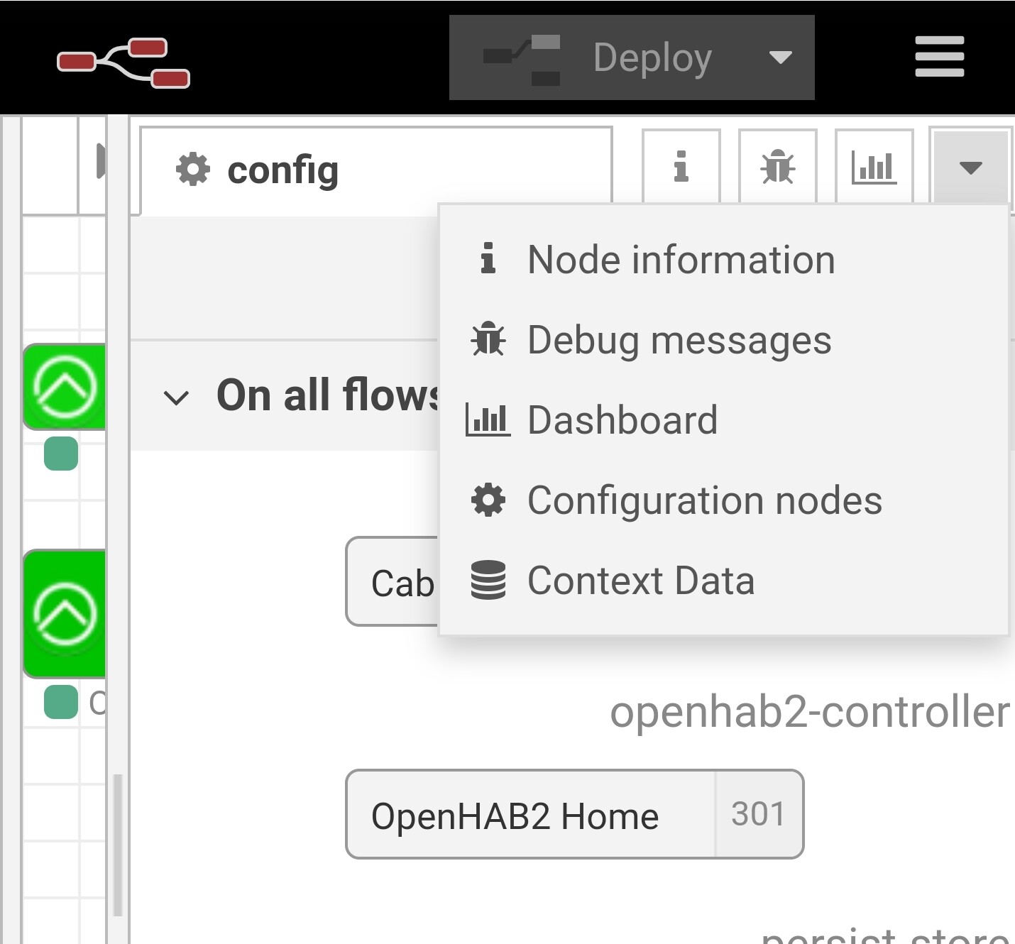

Do you mean that when you try to remove this using the palette manager it tells you that there is a node in use?
If so..
Try using the “Node Configuration” tab in the Right Side bar.
This will tell you where the remaining active nodes are in your flows.
Once removed, you’ll be able to completely remove the whole set.

On the right side bar I have been to “configuration nodes” and deleted everything there. Theres 2, one mqtt server and one ui_tab. I double clicked both and deleted them. it is ui_tab that is the reason I cant just delete the whole package in pallete manager as I cannot disable it here, even after deleting it from the one flow I have open. I will however look into this again shortly to see if I have missed something. Thankyou.
