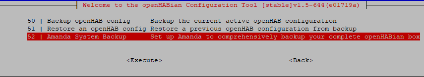

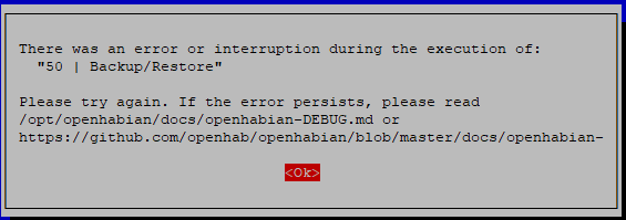

I have already set up and successfully configured amanda backups. however i want to amend the config. When I do this:
I get this:
Any ideas gratefully received.

+ choice2='52 | Amanda System Backup'
+ '[' 0 -eq 1 ']'
+ '[' 1 -eq 255 ']'
+ case "$choice2" in

+ '[' '!' -v PID_APT ']'
+ wait -f 25526
+ '[' 2 -ne 0 ']'
+ whiptail --msgbox 'There was an error or interruption during the execution of:\n  "50 | Backup/Restore"\n\nPlease try again. If the error persists, please read /opt/openhabian/docs/openhabian-DEBUG.md or https://github.com/openhab/openhabian/blob/master/docs/openhabian-DEBUG.md how to proceed.' 12 70
+ return 0

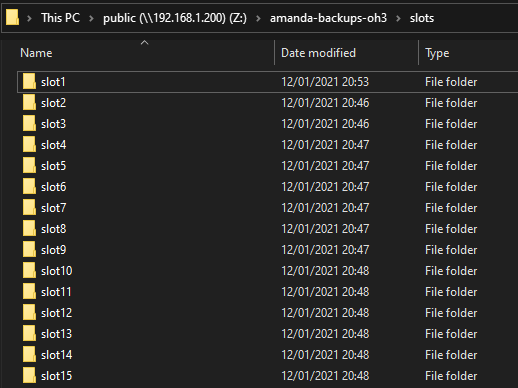

Hi. I have now successfully tested a workaround which was:
  1. Set up amanda back up to a usb drive first. this worked without the permission issue.
  2. Manually edited the amanda.conf file:
openhabian@openHABianDevice:/etc/amanda/openhab-dir $ sudo nano amanda.conf
to replace the pointer folder that i want the amanda dump to be written to.
tpchanger "chg-disk:/mnt/nas/amanda-backups-oh3/slots"
I created the slots folders manually on the nas:
I was able run amdump (as user backup) and then amfetchdump (again as user backup) to restore an image into another folder on the nas:

I am now having the same issue as above where t states there was an error during setup. Currently on 3.0.0-1 and using the Main Branch. I’m not sure how to access the logs though?
Set debugmode=maximum in /etc/openhabian.conf I believe will output all the data in the command line which can be seen once you exit the config screen.
debugmode was already set to maximum, saved and exited the file but didnt see any logs?
