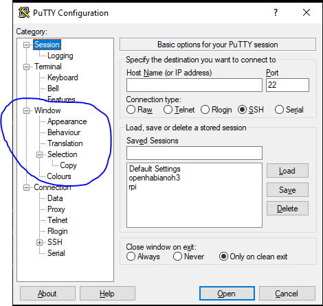

Yes those lines pop up. I always remember that because it says I hope you got what you came for! I’m not to sure what version of putty I am running off the top of my head I will have a look when I’m back home later.
it still has, under “Window”
These are the config options I can see:
click on “Window”

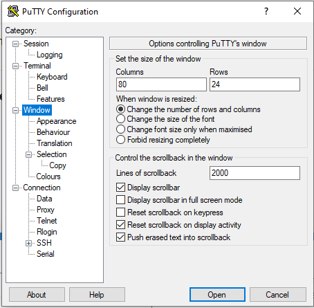

Thanks. I see. I never got that before! In any case it is set as 2000 which is ample. Including screenshot for Taffy’s benefit (maybe).
