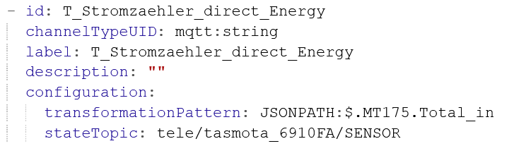

Here the channels (text not working properly, therefore image). Last channel ist the newest:

Thanks! I tried it with the method shown now, but still not working.
Are you editing your Channels using the UI, or modifying the YAML?

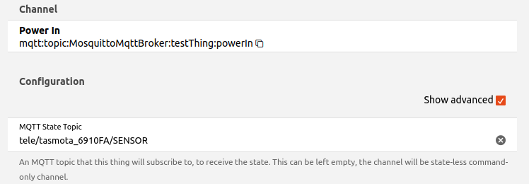

I’ve just created a test Thing, Channel and Item with the following parameters:
Channel
YAML
UID: mqtt:topic:MosquittoMqttBroker:testThing
label: testThing
thingTypeUID: mqtt:topic
configuration: {}
bridgeUID: mqtt:broker:MosquittoMqttBroker
channels:
  - id: powerIn
    channelTypeUID: mqtt:number
    label: Power In
    description: ""
    configuration:
      stateTopic: tele/tasmota_6910FA/SENSOR
      transformationPattern: JSONPATH:$.MT175.Total_in
Item
Link
MQTT

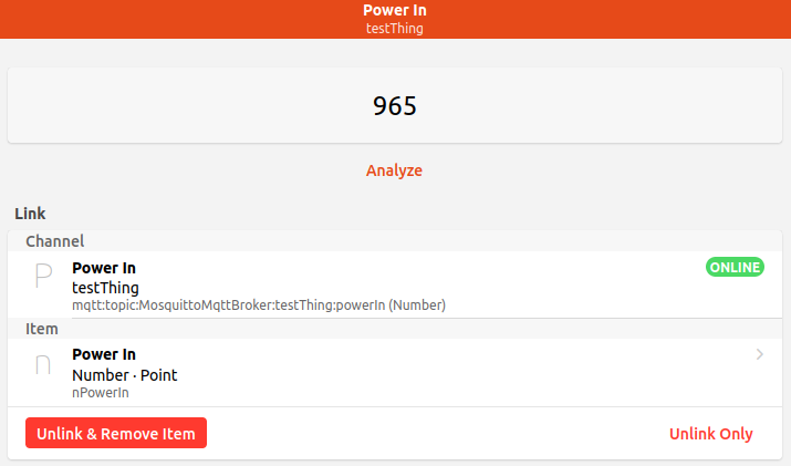

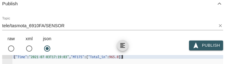

I then sent (note that this has an extra curly brace at the end compared to your snippet)
{"Time":"2021-07-03T17:19:03","MT175":{"Total_in":965.0}}
to
using MQTT Explorer
And as you can see the Item is updating correctly.

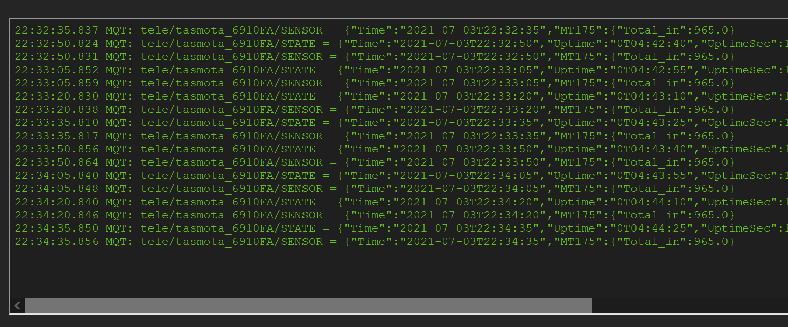

I think this is the problem. Tasmota is missing one curly brace at the end.
22:17:50.828 MQT: tele/tasmota_6910FA/SENSOR = {“Time”:“2021-07-03T22:17:50”,“MT175”:{“Total_in”:965.0}
And then openhab is not able to interprete it. So I think I have to work on this and see how to fix it.

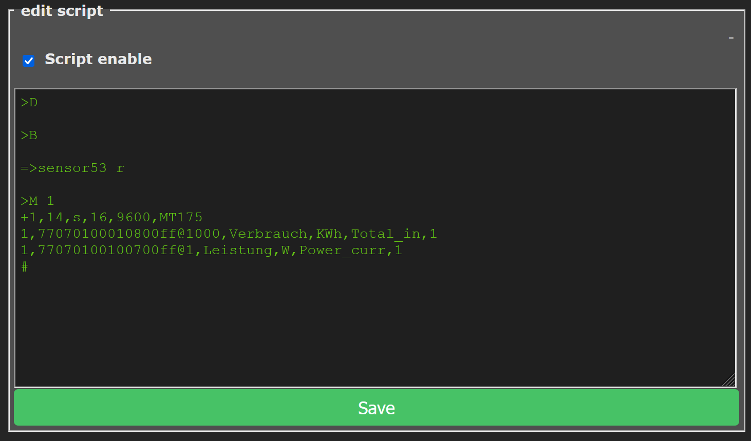

But I had to configure it via script:
And here you see tasmota really mangles the JSON. I do not have a link, it is a esp8266 device to read data from MT175 energy meter.

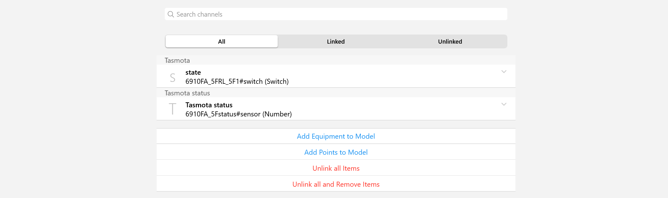

This adds the state and status, but not the sensor information:
UID: mqtt:homeassistant_6910FA:a4e0d49a09:6910FA
label: Tasmota (Switch, Sensor)
thingTypeUID: mqtt:homeassistant_6910FA
configuration:
  topics:
    - switch/6910FA_RL_1
    - sensor/6910FA_status
  basetopic: homeassistant
bridgeUID: mqtt:broker:a4e0d49a09
