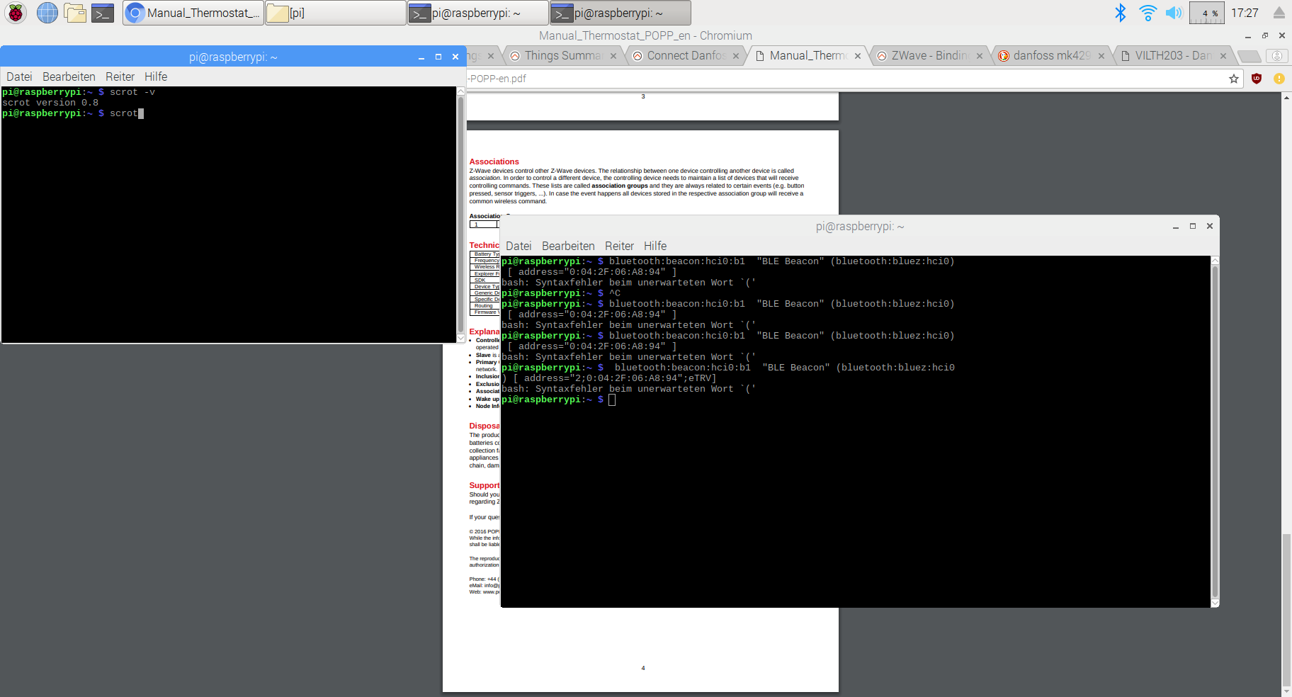

I have tried and i’m having a syntax error
Please post the error your having.
Please check the pic on the right. And this is the adresse my device is actually showing under the Bluetooth devices that are connected.
