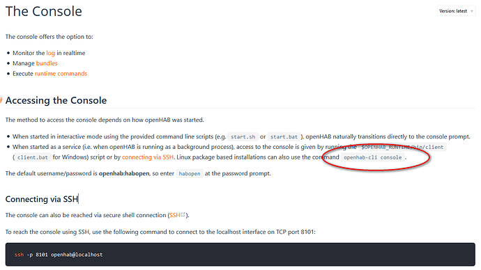

What happens if you try to open the console in this way ?
[12:39:25] hab@openHABianPi:~$ openhab-cli console
Logging in as openhab
__ _____ ____
____ ____ ___ ____ / / / / | / __ )
/ __ \/ __ \/ _ \/ __ \/ /_/ / /| | / __ |
/ /_/ / /_/ / __/ / / / __ / ___ |/ /_/ /
\____/ .___/\___/_/ /_/_/ /_/_/ |_/_____/
/_/ 2.5.0.M1
Milestone Build
Hit '<tab>' for a list of available commands
and '[cmd] --help' for help on a specific command.
Hit '<ctrl-d>' or type 'system:shutdown' or 'logout' to shutdown openHAB.
openhab> logout
[12:40:02] hab@openHABianPi:~$
well, it works not even asking for password, but tutorial didnt mention that console should be started THIS way
