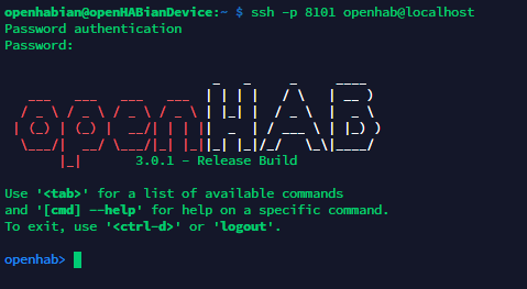

Can you SSH into your PocketBeagle like you normal?
After you have sshed in in the command like enter ssh -p 8101 openhab@localhost dose this open a console?

Yes, the output of netstat showed that the java process is listening on port 8101 ( as well as to other ports ). As you get feedback to your ssh command as well by being logged on to your host as well as from the outside of that host also I would conclude that the karaf console replies to your trials to connect to it. In case it would only listen to localhost but not on conections to the ethernet interface you would get connection refused.
My conclusion now would be that you changed the default password.
Could that have happened ?
A crosscheck ( although I think that this is not required ) to check what is listening on port 8101 from the outside ( just in case that something on your network is rerouted ) could be that you use telnet to connect to port 8101. This then should show the banner of the service on port 8101.
At least this works for e.g. ssh service / karaf console:
telnet localhost 8101
Trying ::1...
Trying 127.0.0.1...
Connected to localhost.
Escape character is '^]'.
SSH-2.0-SSHD-CORE-1.7.0
the last row is evidence that the karaf console is behind port 8101.
