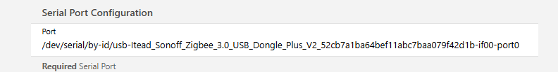

I gave up on the Raspberry Pi 3. Starting from scratch with new Raspberry Pi 5 and openHAB 4.3.2
Based on this: Serial Port Configuration | openHAB

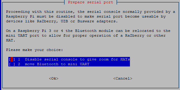

I used openhabian-config to prepare serial port
Rebooted

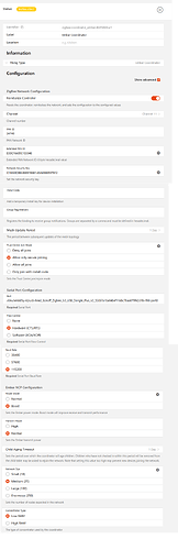

Added the ZigBee Binding. Manually added the Ember Controller thing.
Still initializing>
settings for thing:

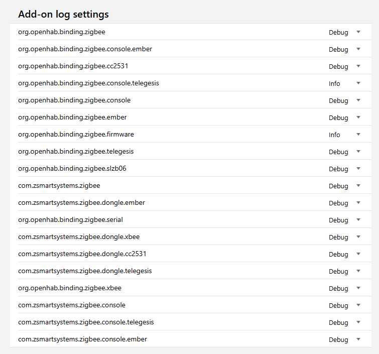

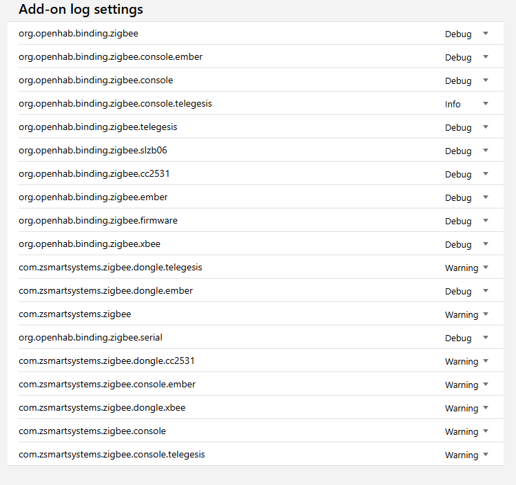

Not sure exactly what to set to debug
[02:43:42] root@openhabian:/# cat ./var/log/openhab/openhab.log | grep DEBUG
2025-02-12 02:41:23.315 [DEBUG] [zigbee.dongle.ember.ZigBeeDongleEzsp] - EZSP Dongle: Shutdown
2025-02-12 02:43:35.090 [DEBUG] [bee.handler.ZigBeeCoordinatorHandler] - null: networkStateUpdated called with state=OFFLINE
2025-02-12 02:43:35.090 [DEBUG] [bee.handler.ZigBeeCoordinatorHandler] - null: networkStateUpdated called with state=SHUTDOWN
2025-02-12 02:43:35.090 [DEBUG] [zigbee.dongle.ember.ZigBeeDongleEzsp] - EZSP Dongle: Shutdown

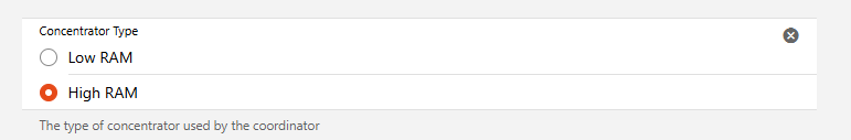

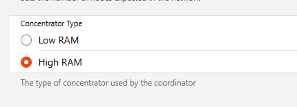

I set this to High RAM and save. It reverts back to Low RAM

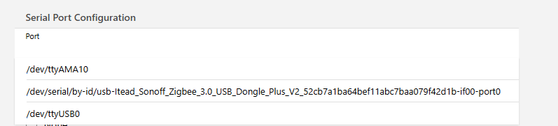

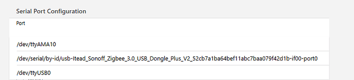

and did I chose the right port, assumed I want the one that says Sonoff

set com.zsmartsystems.zigbee also to debug.
You should view the log using the log file itself - othewise the system will only “display” the last 100 entries - so your grep will show any zigbee log entries in the last 100 entries, and here we see nothing useful - just the shutdown - not the reason or what happened.

It seems the serial port doesn’t exist.

I think that was a test I did. I saw in the documentation that this port was selected so I tried that and got a comm error. The port I selected originally and the one I’ve been troubleshooting is
which looks right since is says Sonoff

Well, I don’t see this port being used in the log. With this log that you’ve provided, the only port I see trying to be opened, and the only initialisation of the binding, it uses /dev/ttyUSB0.

[23:10:30] root@openhabian:/# cat ./var/log/openhab/openhab.log | grep Sonoff
2025-02-14 20:59:20.934 [DEBUG] [ng.zigbee.ember.handler.EmberHandler] - ZigBee Ember Coordinator opening Port:'/dev/serial/by-id/usb-Itead_Sonoff_Zigbee_3.0_USB_Dongle_Plus_V2_52cb7a1ba64bef11abc7baa079f42d1b-if00-port0' PAN:2825, EPAN:BE2AB86558F0AE87, Channel:11
2025-02-14 20:59:21.959 [DEBUG] [nding.zigbee.serial.ZigBeeSerialPort] - Connecting to serial port [/dev/serial/by-id/usb-Itead_Sonoff_Zigbee_3.0_USB_Dongle_Plus_V2_52cb7a1ba64bef11abc7baa079f42d1b-if00-port0] at 115200 baud, flow control FLOWCONTROL_OUT_RTSCTS.
2025-02-14 20:59:22.079 [DEBUG] [nding.zigbee.serial.ZigBeeSerialPort] - Serial port [/dev/serial/by-id/usb-Itead_Sonoff_Zigbee_3.0_USB_Dongle_Plus_V2_52cb7a1ba64bef11abc7baa079f42d1b-if00-port0] is initialized.
Also somehow this setting finally changed

That won’t really change anything wrt initialising the network. It just impacts zigbee network routing between devices so will not be related to your initialisation problems.

Currently the binding is using this port:
Not ttyUSBx
I put Home Assistant on my old Pi and plugged the Sonoff dongle into it. Home Assistant recognized it right away on I confirmed the Baud rate is 115200bps.
So I plugged the dongle back into the Pi 5

chris:
Please do this. It will provide logging so we can see what is going on. At the moment I see very little, and there’s no issue showing up so I can’t really help.

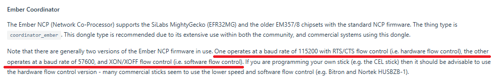

Have you tried using software flow control?

chris:
It was already set to debug
Maybe the entire openhab.log would help so I put on Google drive:
I tried setting to software flow control and 57600 but then I got a com error instead of initializing.

Did you try those settings rather than using 57600?
switch
(Joseph Rogers)
February 16, 2025, 4:29pm
35
Software (XOn/Xoff) and 115200 produces status ONLINE
How to update this documentation?
Also, thank you!
MikeJMajor
(Mike Major)
February 16, 2025, 6:39pm
36
The documentation has already been updated in main, I guess we need to wait until OH 5.0 to see it.
