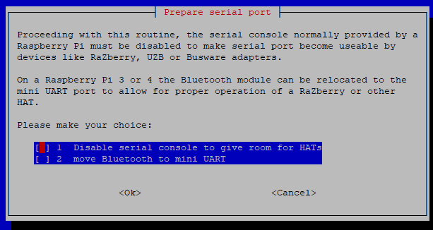

So I think I missed where I set the serial ports using the openHABian munu:
I just ran that and rebooted. The Ember Coordinator still says INITIALIZING.

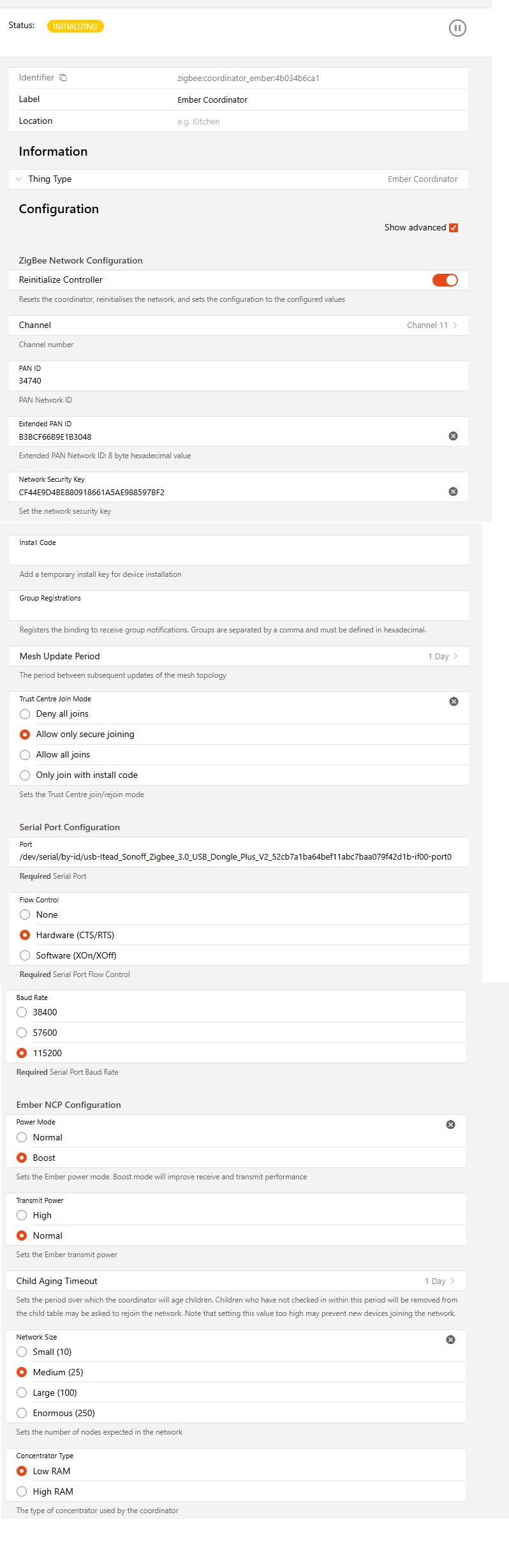

OK, yeah, thanks again. The High RAM wasn’t set correctly.
Still INITIALIZING.
If I’m reading the docs correctly, everything I’m doing is through GUI. Not config files.
This is openHAB 4.0.1 on RaspberyPi 3, openHABian distro
Have you initialised the network? If not, in the coordinator configuration, click advanced settings, then click initialise and save.
Have you tried using software flow control as mentioned here?
Current settings:

2025-02-09 19:32:29.273 [DEBUG] [ng.zigbee.ember.handler.EmberHandler] - Initializing ZigBee Ember serial bridge handler.
2025-02-09 19:32:29.393 [DEBUG] [ng.zigbee.ember.handler.EmberHandler] - ZigBee Ember Coordinator opening Port:'/dev/serial/by-id/usb-Itead_Sonoff_Zigbee_3.0_USB_Dongle_Plus_V2_52cb7a1ba64bef11abc7baa079f42d1b-if00-port0' PAN:87b4, EPAN:B3BCF66B9E1B3048, Channel:11
2025-02-09 19:32:29.395 [DEBUG] [ng.zigbee.ember.handler.EmberHandler] - Ember end device poll timeout set to (169 * 2^9) = 86528 seconds
I need to see more data. The first part (95%) of this is just the binding loading - only the last 3 lines are logging from the binding itself and this is just the very first part of the initialisation where it’s printing the configuration and before initialisation starts.
2025-02-09 19:32:29.395 is the last entry. I’m thinking that my Raspberry Pi3 just can’t handle this version of OpenHAB. GUI becomes unresponsive.
I may be remembering wrongly here as it has been a while but I sort of recall that one of the early versions of OpenHAB 4 had an issue related to serial ports that was fixed in a minor upgrade or someone provided an alternate driver package you might try that package from this link
or maybe bump up to a slightly later version of OH before tossing in the towel on the Rpi 3
