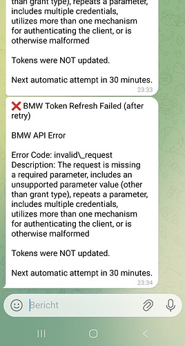

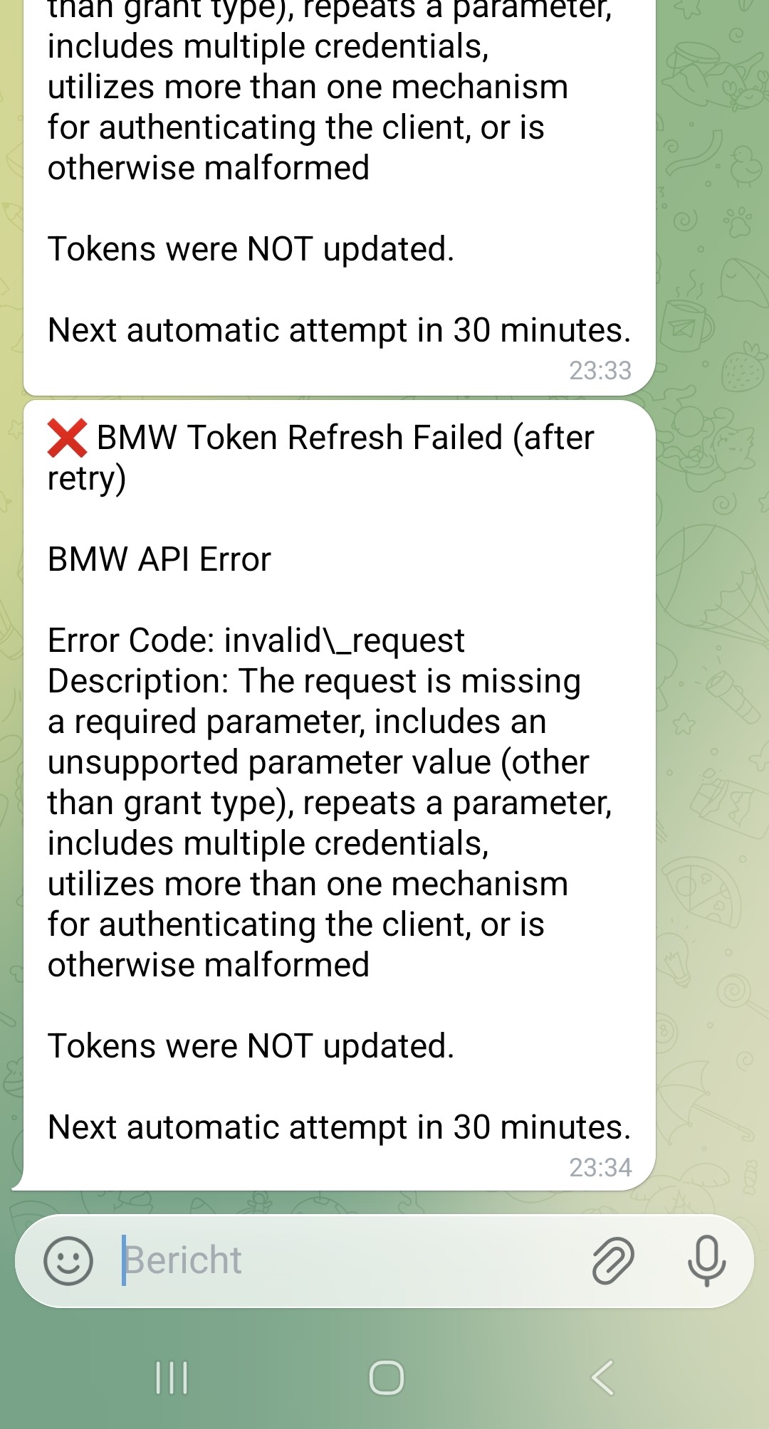

I still get the following errors. The token setup works fine via the Cardata Customer portal (not via Telegram or log file), but the updating is not working for me:

2025-12-10 23:33:00.979 [ERROR] [enhab.core.model.script.actions.HTTP] - Fatal transport error: java.util.concurrent.ExecutionException: java.io.EOFException: @67210ce7::DecryptedEndPoint@2ebabc8b{l=/192.168.200.72:61485,r=customer.bmwgroup.com/35.227.244.195:443,OPEN,fill=-,flush=-,to=3206748/0}
2025-12-10 23:33:00.979 [ERROR] [omation.openhab-js.BMW_Token_Refresh] - No valid response received from BMW. Tokens will NOT be updated!
2025-12-10 23:33:00.980 [WARN ] [omation.openhab-js.BMW_Token_Refresh] - First attempt failed. Will retry in 30 seconds.
2025-12-10 23:33:00.980 [WARN ] [omation.openhab-js.BMW_Token_Refresh] - Scheduling retry in 30 seconds...
2025-12-10 23:33:30.981 [INFO ] [omation.openhab-js.BMW_Token_Refresh] - === RETRY ATTEMPT - Second try after initial failure ===
2025-12-10 23:33:30.982 [INFO ] [omation.openhab-js.BMW_Token_Refresh] - Starting token refresh...
2025-12-10 23:33:31.245 [ERROR] [omation.openhab-js.BMW_Token_Refresh] - BMW API returned error
2025-12-10 23:33:31.246 [ERROR] [omation.openhab-js.BMW_Token_Refresh] - Error Code: invalid_request
2025-12-10 23:33:31.246 [ERROR] [omation.openhab-js.BMW_Token_Refresh] - Error Description: The request is missing a required parameter, includes an unsupported parameter value (other than grant type), repeats a parameter, includes multiple credentials, utilizes more than one mechanism for authenticating the client, or is otherwise malformed
2025-12-10 23:33:31.246 [ERROR] [omation.openhab-js.BMW_Token_Refresh] - Full JSON Response: {"error": "invalid_request", "error_description": "The request is missing a required parameter, includes an unsupported parameter value (other than grant type), repeats a parameter, includes multiple credentials, utilizes more than one mechanism for authenticating the client, or is otherwise malformed"}
2025-12-10 23:34:00.958 [INFO ] [hab-js.BMW_Token_Refresh_ExpireCheck] - current time: 10.12.2025 23:34:00, expiry of token: 10.12.2025 23:32:59
2025-12-10 23:34:00.958 [INFO ] [omation.openhab-js.BMW_Token_Refresh] - Token needs to be updated! -> Starting update
2025-12-10 23:34:00.958 [INFO ] [omation.openhab-js.BMW_Token_Refresh] - Starting token refresh...
2025-12-10 23:34:01.069 [ERROR] [omation.openhab-js.BMW_Token_Refresh] - BMW API returned error
2025-12-10 23:34:01.069 [ERROR] [omation.openhab-js.BMW_Token_Refresh] - Error Code: invalid_request
2025-12-10 23:34:01.069 [ERROR] [omation.openhab-js.BMW_Token_Refresh] - Error Description: The request is missing a required parameter, includes an unsupported parameter value (other than grant type), repeats a parameter, includes multiple credentials, utilizes more than one mechanism for authenticating the client, or is otherwise malformed
2025-12-10 23:34:01.070 [ERROR] [omation.openhab-js.BMW_Token_Refresh] - Full JSON Response: {"error": "invalid_request", "error_description": "The request is missing a required parameter, includes an unsupported parameter value (other than grant type), repeats a parameter, includes multiple credentials, utilizes more than one mechanism for authenticating the client, or is otherwise malformed"}
2025-12-10 23:34:01.070 [WARN ] [omation.openhab-js.BMW_Token_Refresh] - First attempt failed with BMW API error. Will retry in 30 seconds.
2025-12-10 23:34:01.070 [WARN ] [omation.openhab-js.BMW_Token_Refresh] - Scheduling retry in 30 seconds...
2025-12-10 23:34:31.073 [INFO ] [omation.openhab-js.BMW_Token_Refresh] - === RETRY ATTEMPT - Second try after initial failure ===
2025-12-10 23:34:31.073 [INFO ] [omation.openhab-js.BMW_Token_Refresh] - Starting token refresh...
2025-12-10 23:34:31.142 [ERROR] [omation.openhab-js.BMW_Token_Refresh] - BMW API returned error
2025-12-10 23:34:31.142 [ERROR] [omation.openhab-js.BMW_Token_Refresh] - Error Code: invalid_request
2025-12-10 23:34:31.142 [ERROR] [omation.openhab-js.BMW_Token_Refresh] - Error Description: The request is missing a required parameter, includes an unsupported parameter value (other than grant type), repeats a parameter, includes multiple credentials, utilizes more than one mechanism for authenticating the client, or is otherwise malformed
2025-12-10 23:34:31.142 [ERROR] [omation.openhab-js.BMW_Token_Refresh] - Full JSON Response: {"error": "invalid_request", "error_description": "The request is missing a required parameter, includes an unsupported parameter value (other than grant type), repeats a parameter, includes multiple credentials, utilizes more than one mechanism for authenticating the client, or is otherwise malformed"}
2025-12-10 23:35:00.958 [INFO ] [hab-js.BMW_Token_Refresh_ExpireCheck] - current time: 10.12.2025 23:35:00, expiry of token: 10.12.2025 23:32:59
2025-12-10 23:35:00.958 [INFO ] [omation.openhab-js.BMW_Token_Refresh] - Token needs to be updated! -> Starting update
2025-12-10 23:35:00.958 [INFO ] [omation.openhab-js.BMW_Token_Refresh] - Starting token refresh...
2025-12-10 23:35:01.029 [ERROR] [omation.openhab-js.BMW_Token_Refresh] - BMW API returned error
2025-12-10 23:35:01.030 [ERROR] [omation.openhab-js.BMW_Token_Refresh] - Error Code: invalid_request
2025-12-10 23:35:01.030 [ERROR] [omation.openhab-js.BMW_Token_Refresh] - Error Description: The request is missing a required parameter, includes an unsupported parameter value (other than grant type), repeats a parameter, includes multiple credentials, utilizes more than one mechanism for authenticating the client, or is otherwise malformed
2025-12-10 23:35:01.030 [ERROR] [omation.openhab-js.BMW_Token_Refresh] - Full JSON Response: {"error": "invalid_request", "error_description": "The request is missing a required parameter, includes an unsupported parameter value (other than grant type), repeats a parameter, includes multiple credentials, utilizes more than one mechanism for authenticating the client, or is otherwise malformed"}
2025-12-10 23:35:01.030 [WARN ] [omation.openhab-js.BMW_Token_Refresh] - First attempt failed with BMW API error. Will retry in 30 seconds.
2025-12-10 23:35:01.030 [WARN ] [omation.openhab-js.BMW_Token_Refresh] - Scheduling retry in 30 seconds...
2025-12-10 23:35:31.032 [INFO ] [omation.openhab-js.BMW_Token_Refresh] - === RETRY ATTEMPT - Second try after initial failure ===
2025-12-10 23:35:31.033 [INFO ] [omation.openhab-js.BMW_Token_Refresh] - Starting token refresh...
2025-12-10 23:35:31.104 [ERROR] [omation.openhab-js.BMW_Token_Refresh] - BMW API returned error
2025-12-10 23:35:31.105 [ERROR] [omation.openhab-js.BMW_Token_Refresh] - Error Code: invalid_request
2025-12-10 23:35:31.105 [ERROR] [omation.openhab-js.BMW_Token_Refresh] - Error Description: The request is missing a required parameter, includes an unsupported parameter value (other than grant type), repeats a parameter, includes multiple credentials, utilizes more than one mechanism for authenticating the client, or is otherwise malformed
2025-12-10 23:35:31.105 [ERROR] [omation.openhab-js.BMW_Token_Refresh] - Full JSON Response: {"error": "invalid_request", "error_description": "The request is missing a required parameter, includes an unsupported parameter value (other than grant type), repeats a parameter, includes multiple credentials, utilizes more than one mechanism for authenticating the client, or is otherwise malformed"}
2025-12-10 23:36:00.958 [INFO ] [hab-js.BMW_Token_Refresh_ExpireCheck] - current time: 10.12.2025 23:36:00, expiry of token: 10.12.2025 23:32:59
2025-12-10 23:36:00.958 [INFO ] [omation.openhab-js.BMW_Token_Refresh] - Token needs to be updated! -> Starting update
2025-12-10 23:36:00.959 [INFO ] [omation.openhab-js.BMW_Token_Refresh] - Starting token refresh...
2025-12-10 23:36:01.066 [ERROR] [omation.openhab-js.BMW_Token_Refresh] - BMW API returned error
2025-12-10 23:36:01.066 [ERROR] [omation.openhab-js.BMW_Token_Refresh] - Error Code: invalid_request
2025-12-10 23:36:01.066 [ERROR] [omation.openhab-js.BMW_Token_Refresh] - Error Description: The request is missing a required parameter, includes an unsupported parameter value (other than grant type), repeats a parameter, includes multiple credentials, utilizes more than one mechanism for authenticating the client, or is otherwise malformed
2025-12-10 23:36:01.066 [ERROR] [omation.openhab-js.BMW_Token_Refresh] - Full JSON Response: {"error": "invalid_request", "error_description": "The request is missing a required parameter, includes an unsupported parameter value (other than grant type), repeats a parameter, includes multiple credentials, utilizes more than one mechanism for authenticating the client, or is otherwise malformed"}
2025-12-10 23:36:01.066 [WARN ] [omation.openhab-js.BMW_Token_Refresh] - First attempt failed with BMW API error. Will retry in 30 seconds.
2025-12-10 23:36:01.067 [WARN ] [omation.openhab-js.BMW_Token_Refresh] - Scheduling retry in 30 seconds...
2025-12-10 23:36:11.330 [INFO ] [.reconnect.PeriodicReconnectStrategy] - Try to restore connection to 'customer.streaming-cardata.bmwgroup.com'. Next attempt in 60000ms
2025-12-10 23:36:11.332 [INFO ] [.transport.mqtt.MqttBrokerConnection] - Starting MQTT broker connection to 'customer.streaming-cardata.bmwgroup.com' with clientid 9e34e8d0-1f35-477d-879f-ad778a0f69df
2025-12-10 23:36:31.068 [INFO ] [omation.openhab-js.BMW_Token_Refresh] - === RETRY ATTEMPT - Second try after initial failure ===
2025-12-10 23:36:31.069 [INFO ] [omation.openhab-js.BMW_Token_Refresh] - Starting token refresh...
2025-12-10 23:36:31.169 [ERROR] [omation.openhab-js.BMW_Token_Refresh] - BMW API returned error
2025-12-10 23:36:31.169 [ERROR] [omation.openhab-js.BMW_Token_Refresh] - Error Code: invalid_request
2025-12-10 23:36:31.169 [ERROR] [omation.openhab-js.BMW_Token_Refresh] - Error Description: The request is missing a required parameter, includes an unsupported parameter value (other than grant type), repeats a parameter, includes multiple credentials, utilizes more than one mechanism for authenticating the client, or is otherwise malformed
2025-12-10 23:36:31.169 [ERROR] [omation.openhab-js.BMW_Token_Refresh] - Full JSON Response: {"error": "invalid_request", "error_description": "The request is missing a required parameter, includes an unsupported parameter value (other than grant type), repeats a parameter, includes multiple credentials, utilizes more than one mechanism for authenticating the client, or is otherwise malformed"}
2025-12-10 23:37:00.958 [INFO ] [hab-js.BMW_Token_Refresh_ExpireCheck] - current time: 10.12.2025 23:37:00, expiry of token: 10.12.2025 23:32:59
2025-12-10 23:37:00.958 [INFO ] [omation.openhab-js.BMW_Token_Refresh] - Token needs to be updated! -> Starting update
2025-12-10 23:37:00.959 [INFO ] [omation.openhab-js.BMW_Token_Refresh] - Starting token refresh...
