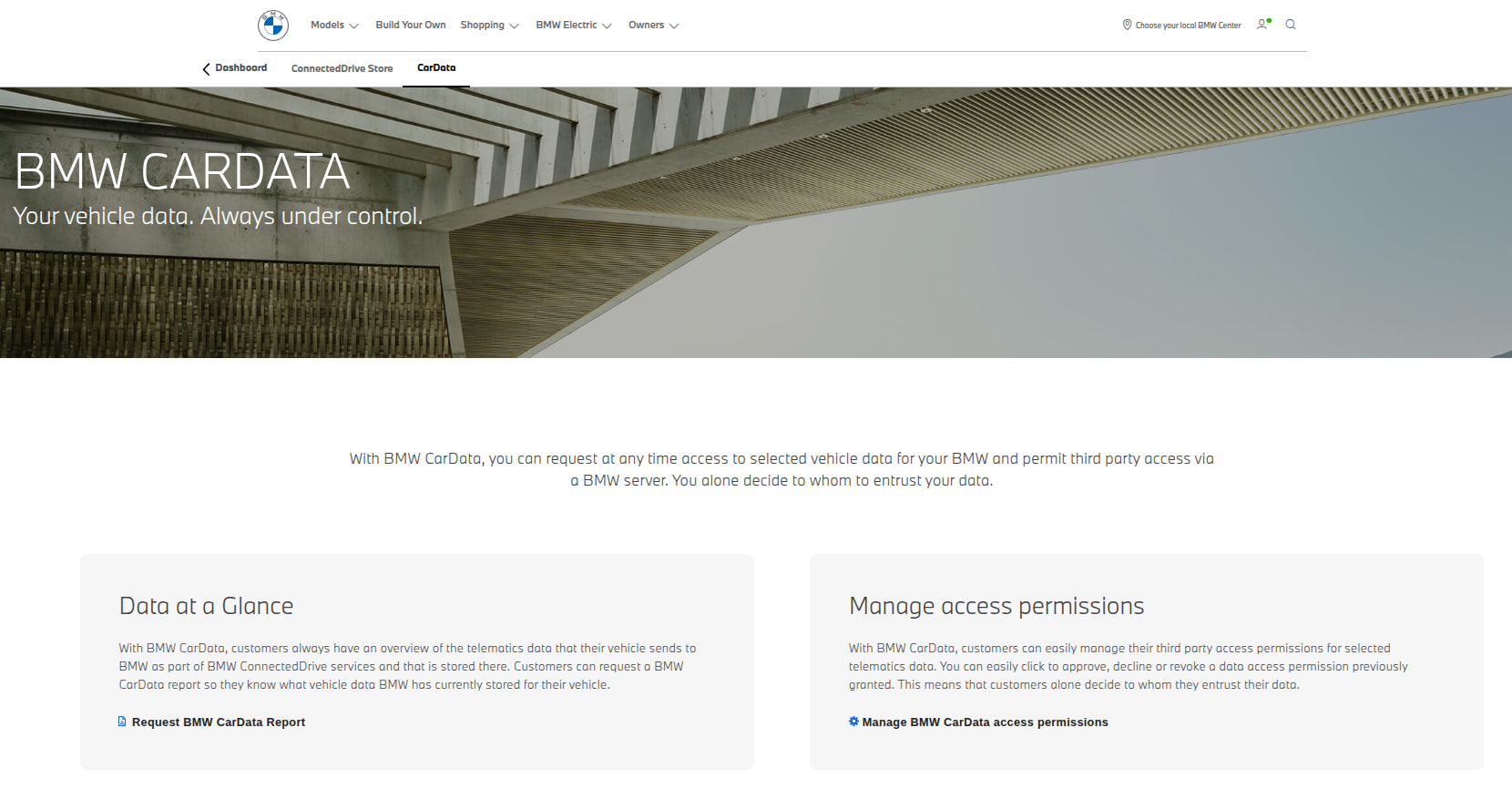

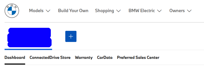

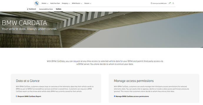

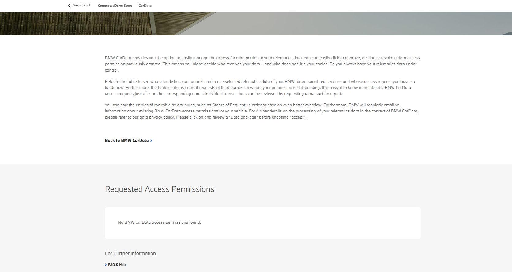

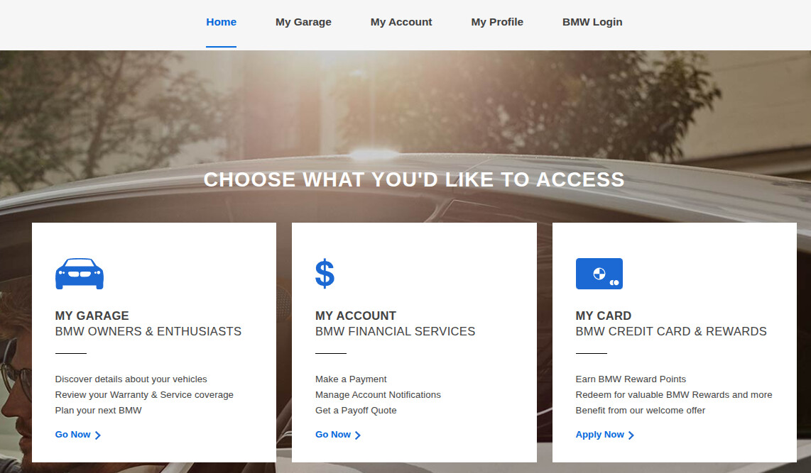

Trying the link you provided to set up the CarData, I cannot log in at this link, despite having a BMW connected drive account. I’m in the US and wondering if the link to geo specific? If I go to https://www.bmwusa.com/, I can log into my account with my usual uname/passwd.
From there, trying to find where I can do what you described:. I start here:
Then to ā€œMy Garageā€
Then to ā€œCarDataā€
Then to ā€œManage Access Permissionsā€
Once I’m here I don’t see anywhere to create a client. Any idea if this is possible from BMW-USA?
