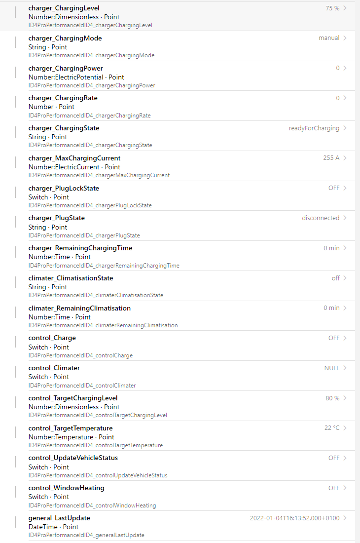

Hello.
Is there anyone who actually have managed to control the Climater with this binding?
I could get readings what state the Climate system is in but I could not turn it on/off.
This is an ID.4
Error message: 2022-01-04 17:37:17.773 [DEBUG] [nectedcar.internal.api.ApiHttpClient] : HTTP 400..Response: { “error”: { “message”: “The provided request is incorrect”, “info”: “Internal error, please try again later. If the problem persists, please contact our support.”, “code”: 2105, “group”: 2, “retry”: true }}

Okey, I figured it out, to be able to start the Climatisation on an ID.4 you need to send the configuration for the Climater as a JSON Body, you could ignore to send the Timestamp (carCapturedTimestamp)
This is an example from my settings that should be added as body to the POST request.
“targetTemperature_C”: 22,
“targetTemperature_F”: 72,
“unitInCar”: “celsius”,
“climatisationWithoutExternalPower”: true,
“climatizationAtUnlock”: true,
“windowHeatingEnabled”: true,
“zoneFrontLeftEnabled”: true,
“zoneFrontRightEnabled”: false,
“targetTemperature_K”: 295.15
