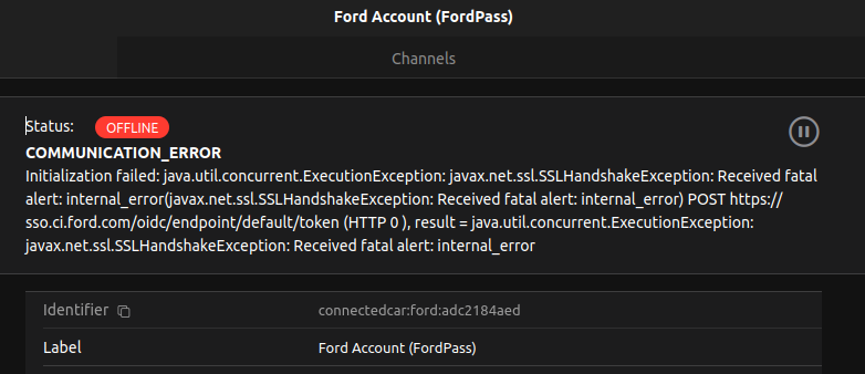

Hi all
with FordPass the binding doesn’t work
do you experience the same issue?

Dose anyone knows how to fix this issue for FordPass
I tested with OpenHab 4.0 didn’t work, I did a update to 4.1.3 and the problem persist.
I try all the addons from 4.0.4 to 4.1.2
Thing 'connectedcar:ford:1196573938' changed from UNKNOWN to OFFLINE (COMMUNICATION_ERROR): Initialization failed: java.util.concurrent.ExecutionException: javax.net.ssl.SSLHandshakeException: Received fatal alert: internal_error(javax.net.ssl.SSLHandshakeException: Received fatal alert: internal_error) POST https://sso.ci.ford.com/oidc/endpoint/default/token (HTTP 0 ), result = java.util.concurrent.ExecutionException: javax.net.ssl.SSLHandshakeException: Received fatal alert: internal_error

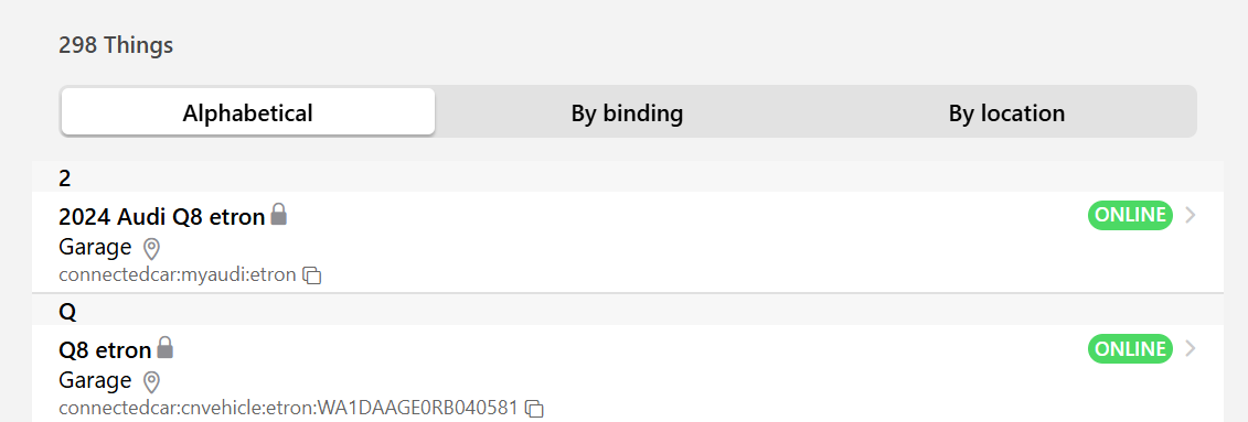

How I can force the biding to use audiusa.com - I have a 2024 Q8 eTron registered with audiusa.com but the binding keeps going to the https://my.audi.com/ - I registered my car in the http://my.audi.com site but i cannot complete registration because it asks me to login into the app or auto MMI to authorize services - I was thinking about using VPN to force my phone to think it is in UK but it is too much work. I can get the Things online but no channels. I can help troubleshoot.
@gforums please try to download from here:
If you use the latest binding it does not work for Audi (etron) based models. You can try the binding I shared for 4.1.1 OpenHab that has the revert to get Audi (etron) models working again.
