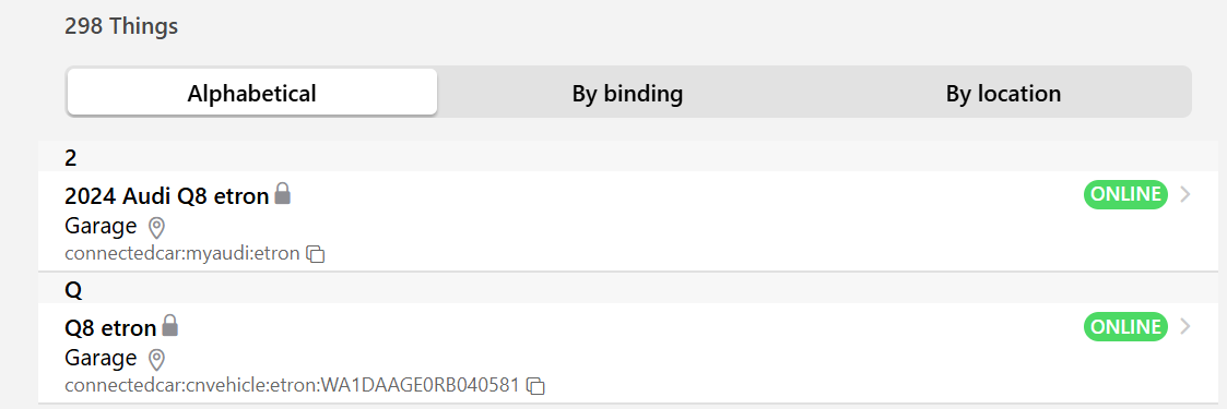

Still no channels with the etron binding - anything i can try ? I still think is trying to use the UK site

Did you recreate the binding / vehicle as that still does not look right. It should show you a idvechicle for it to be working.

Yes, I did it both ways and still no channels
regards
Harry
