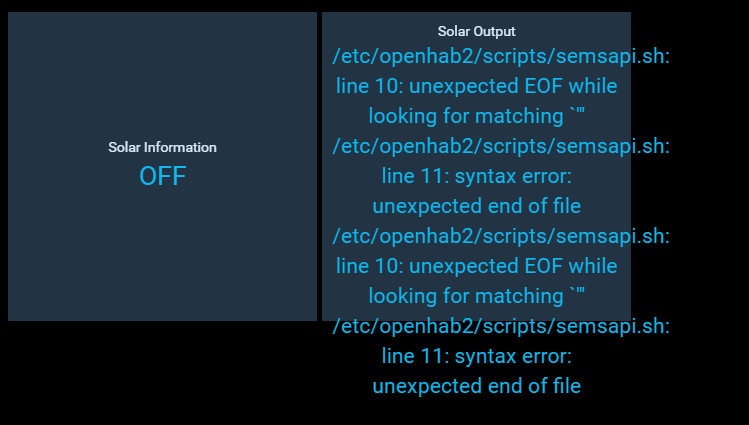

hello, i tryied your guide, but im doing something wrong..
/etc/openhab2/scripts/semsapi.sh a copied your script into file and updated login, password and id.
then i bind excec binding and json.
then i tryied run the script and i have few errors - below.
in the exec bind i have settings:
command: bash /etc/openhab2/scripts/semsapi.sh
transform: REGEX((.*))
where could be mistake?
thanks a lot, a im new in OH, just trying, that is good platform for me..everythings work fine, but i dont understant this not so much..
/etc/openhab2/scripts/semsapi.sh: line 2: $‘\r’: command not found /etc/openhab2/scripts/semsapi.sh: line 3: curl: command not found /etc/openhab2/scripts/semsapi.sh: line 4: $‘\r’: command not found /etc/openhab2/scripts/semsapi.sh: line 5: jq: command not found /etc/openhab2/scripts/semsapi.sh: line 6: $‘\r’: command not found /etc/openhab2/scripts/semsapi.sh: line 7: curl: command not found /etc/openhab2/scripts/semsapi.sh: line 8: $‘\r’: command not found /etc/openhab2/scripts/semsapi.sh: line 9: jq: command not found /etc/openhab2/scripts/semsapi.sh: line 2: $‘\r’: command not found /etc/openhab2/scripts/semsapi.sh: line 3: curl: command not found /etc/openhab2/scripts/semsapi.sh: line 4: $‘\r’: command not found /etc/openhab2/scripts/semsapi.sh: line 5: jq: command not found /etc/openhab2/scripts/semsapi.sh: line 6: $‘\r’: command not found /etc/openhab2/scripts/semsapi.sh: line 7: curl: command not found /etc/openhab2/scripts/semsapi.sh: line 8: $‘\r’: command not found /etc/openhab2/scripts/semsapi.sh: line 9: jq: command not found
