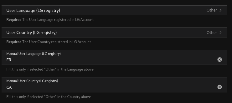

OK… when you created your account on LG Thinq Portal, what country and language you choose ?
This error message says your account is from CA (Canada) and than… you have to registry your language as you choose in the LG Account Portal, you can’t choose a language that is not official in your country and is not associated with your account. Than… in your case can be FR or EN.
So… in the Bridge configuration, you mas choose User Country->Other and put ā€œCAā€ in Manual Contry and in the User Language->Other and put ā€œFRā€ or ā€œENā€ in Manual Language based on the language you associate your account. That… can be something like this:
Ah, CA was the problem. Funny thing is if I put something else then US, it throw another error totally, that’s why I though it wasn’t that. And when I tried, I put Canada instead of CA. Didn’t need to put FR since it’s in english.
To be honest, my account was created over a year ago from the apps, so I really don’t know what were the option and the apps doesn’t show me anything beside language thus I didn’t knew what region I had (and when Canada isn’t in the option, I put USA). I never been to the LG Account Portal, was create through the android app for my washer.
American English did work for language, bridge is now online. Maybe we could add Canada in the list?
Thank you!

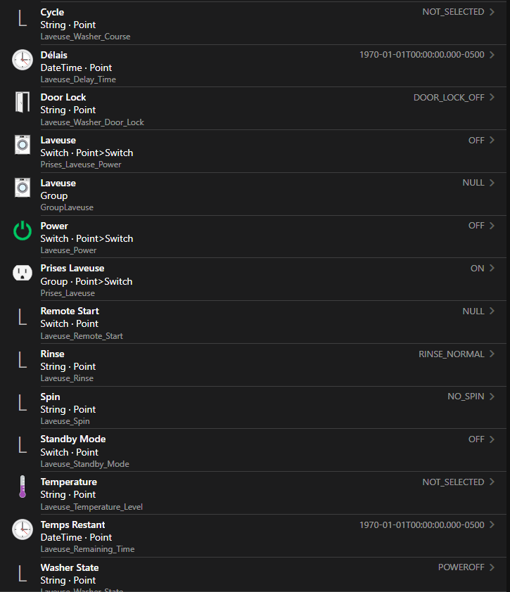

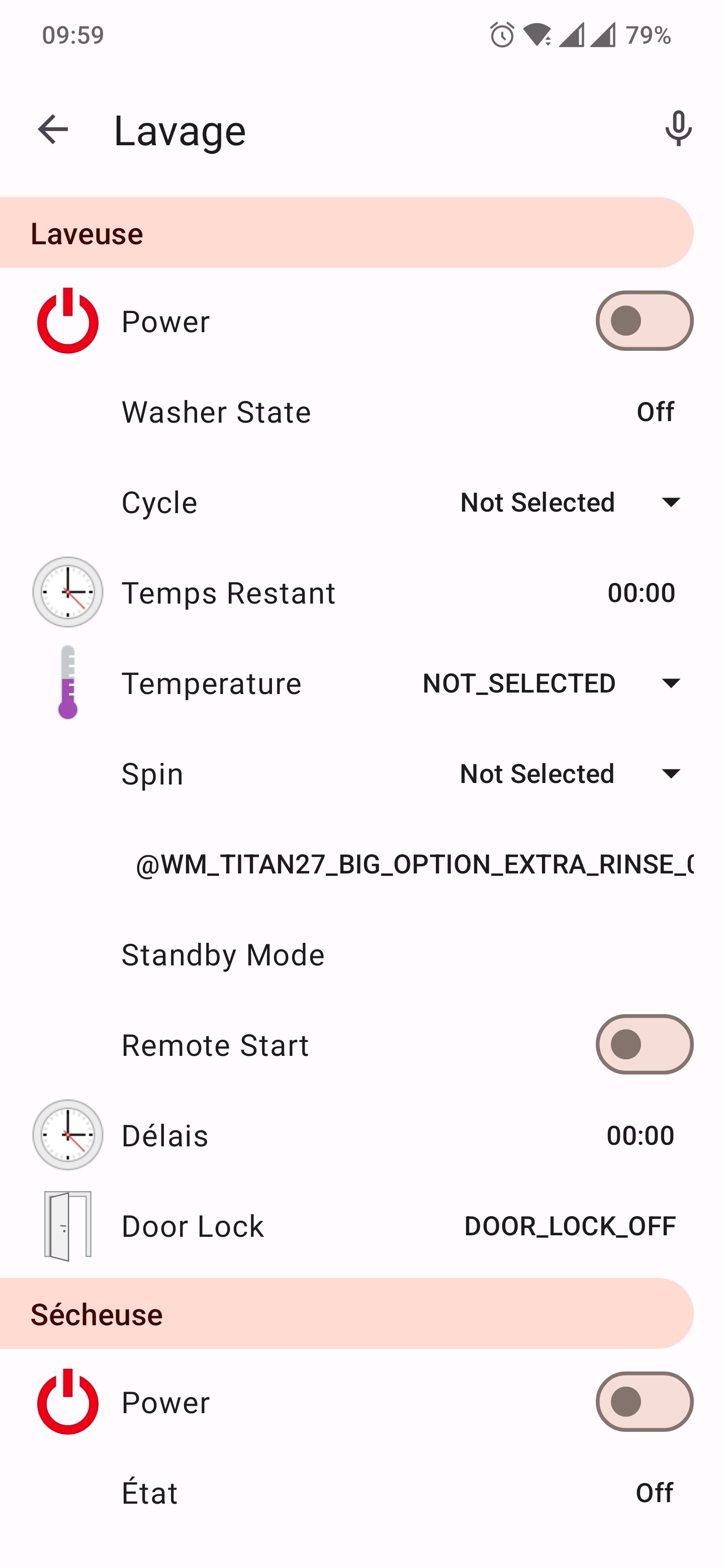

I’m having some weird stuff on my washer (I’ll check dryer later). Here’s my sitemap:
Default item=Laveuse_Power label="Power"
                Text item=Laveuse_Washer_State label="Washer State"
                Selection item=Laveuse_Washer_Course label="Cycle"
                Default item=Laveuse_Remaining_Time label="Temps Restant"
                Selection item=Laveuse_Temperature_Level label="Temperature"
                Selection item=Laveuse_Spin label="Spin"
                Selection item=Laveuse_Rinse label="Rinse"
                Text item=Laveuse_Standby_Mode label="Standby Mode"
                Default item=Laveuse_Remote_Start label="Remote Start"
                Default item=Laveuse_Delay_Time label="DƩlais"
                Default item=Laveuse_Washer_Door_Lock label="Door Lock"
Items are defined in the gui from the thing directly

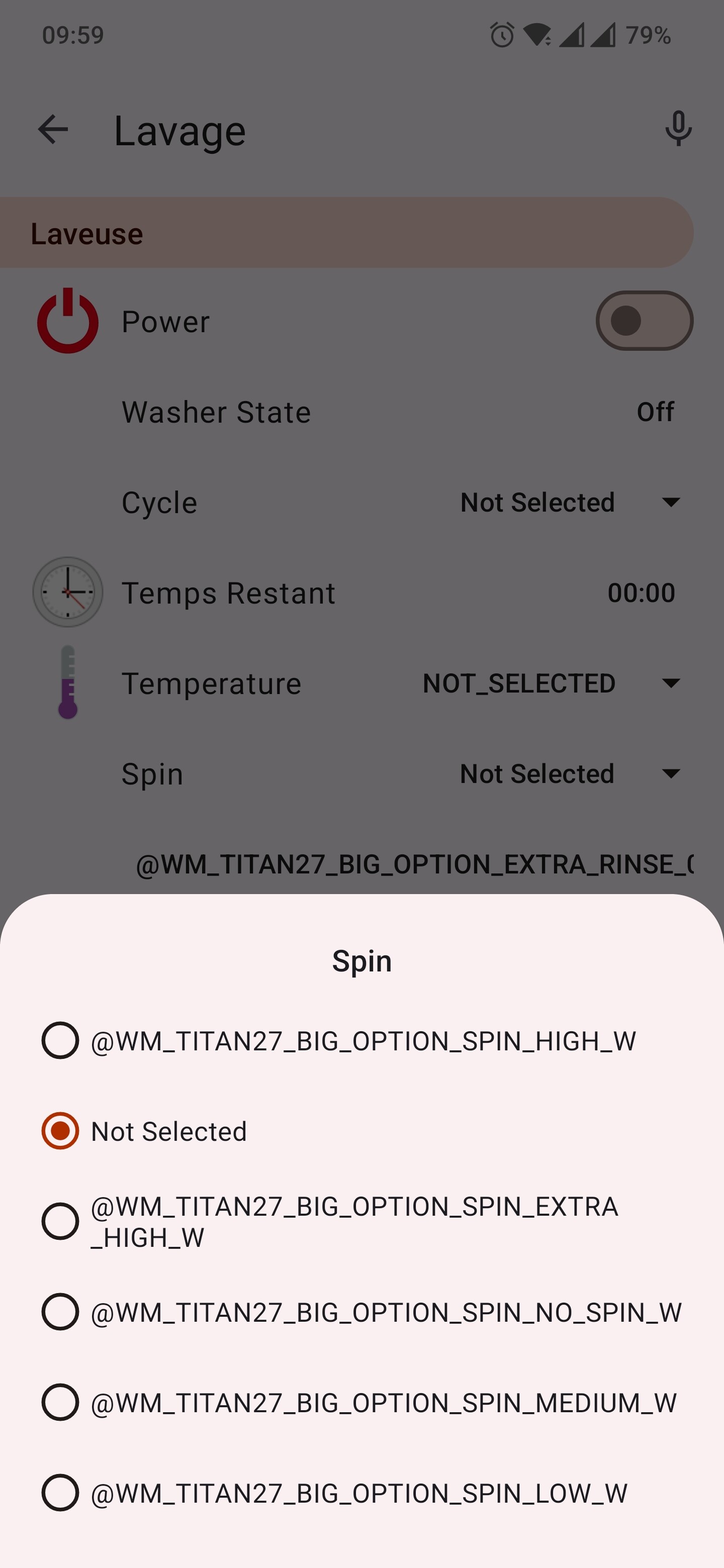

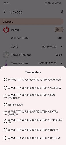

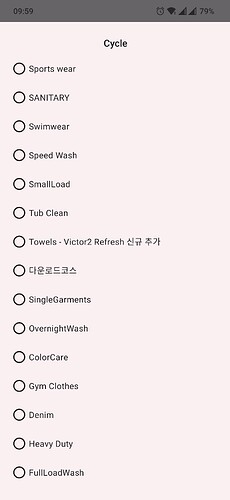

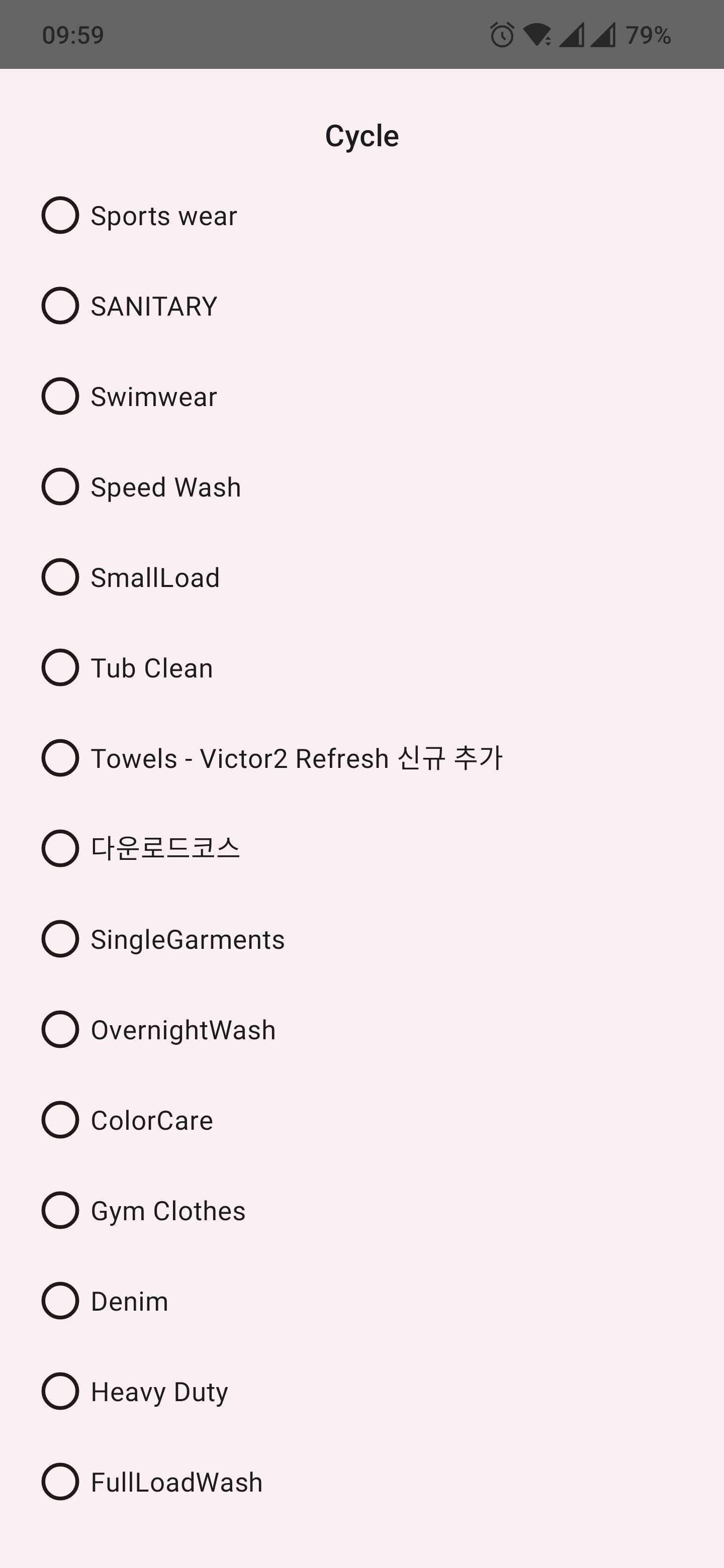

When I’m on my phone, I see this:
Rinse doesn’t seems to want to appear as a select box.
The content of Cycle, Spin and Temperature are weird and include foreign language (that I’m probably sure don’t even work with mine since I don’t see them in the app, unless this include also downloadable one?)

Hi guys, I uploaded a new version of the binding with the following new features for WM/Dryer
  • Dynamic features (channels) for WM/Dryer remote start: when you configure the course and enable remote start (with standby off), the a Group called (Remote Start) will come up with the parameterized features (rinse, spin, temperature, etc) depending on the Course capability defined and supported by the device.
  • To start the WM in remote start function, just put in ON the Remote Start/Stop switch
  • Fixed support for custom Zoned Date/Time. For some cases, in some countries/languages, OH can’t parse the date/time for the binding that couses erros to present Remaining and Delay time.
OBS: The remote start for VW/Dryer V1 was not implemented yet. It’s a little more complicated because needs to create a bitmap to send. It’s a TODO for now.

I installer the new binding with restart and all, now the ui show the rinse cycle, but all selection box are empty.
But as soon as I restarted, it got back to the screenshot above. Could it be due to persistence? I’ll try to disable influxdb on these values.

@Nodiaque, your devices has different schema descriptions. I did an update and hope you can see the channels better right now. Please, update your addon with the latest from my repository and let me know
