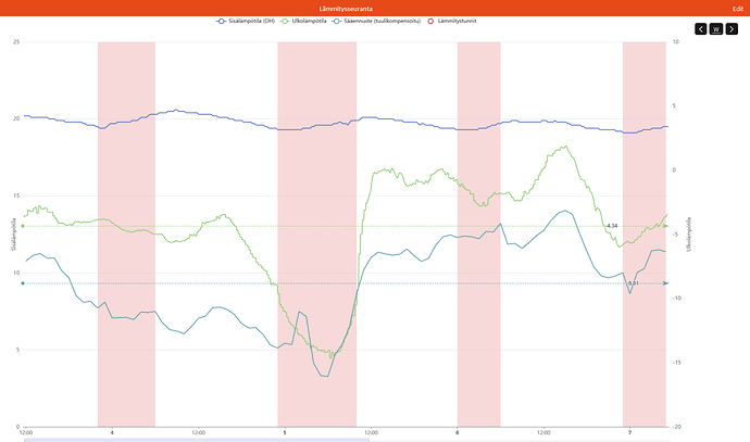

On January 4th the heating stopped at 06:00 and the inside temperature peaked at 09:00 at 20.5 C. At 23:00 the temperature had decreased to 19.3 C. This decrease is noticeable, but we’re used to it and it doesn’t bother us too much
Our family is optimizing cost in favor of comfort so we can tolerate this 1.2 degree dip. But not all families want to take it to this extreme and has higher weight for comfort, which means that you can’t leave the house unheated from 06:00 until 23:00. Which means that you need to allow some amount of heating in between. Which means that you either do the scheduling manually, or you let the algorithm do it for you automatically. If you want to automate it, you need an algorithm that can select the least expensive hours before the absolute cheapest period starts at 23.00.

No worries… The day is a good and representative example of a cold and windy day. I updated the screenshot of my previous comment because it had cropped so that the right Y-axis was not visible so the outdoor temperature scale was not properly visible.
Now you can see from the screenshot that the outdoor temperature was -5 and dropped to -15. However, it was also a windy day. When it’s both cold AND windy, the heat loss is faster. That’s why I have that third temperature line which represents the “wind chill compensated temperature”. It was colder than -10 from the beginning and went below -15 on that day.
