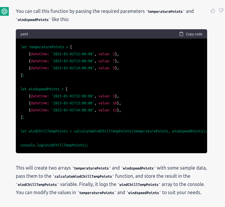

Because I am no coder I asked ChatGPT how to call the windchill calculator method. This is what it suggested:
I further asked it to add start and end times to the script. Here is what it suggested. Would this be what you expected @masipila?

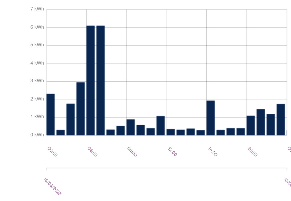

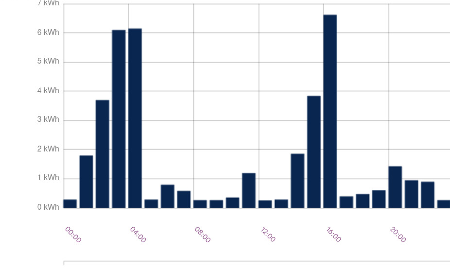

Some reporting of how well the code now works.
Control 15.3.2023
Actual energy consumption from power company reporting system for 15.3.2023
Control 16.3.2023
Actual consumption 16.3.2023
One can see from the graphs that heating is the dominating energy consumption in our house and @masipila 's code succeeds nicely in controlling our heat pump to run only on the cheapest hours. Thanks Markus, this is great!
