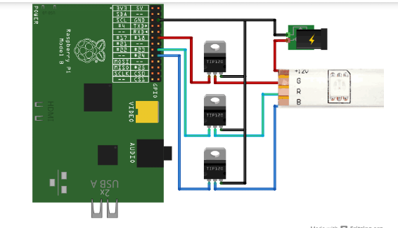

About SMD5050 with 12v power:
Is this connection ok (using tip120 transistor). and there will no damage to raspberry pi?
Other than the Red/Green signal lines reversed on the strip, that looks OK. Just make sure not to reverse any connections (on the transistors or the DC plug), or you will let the magic smoke out ![]()
