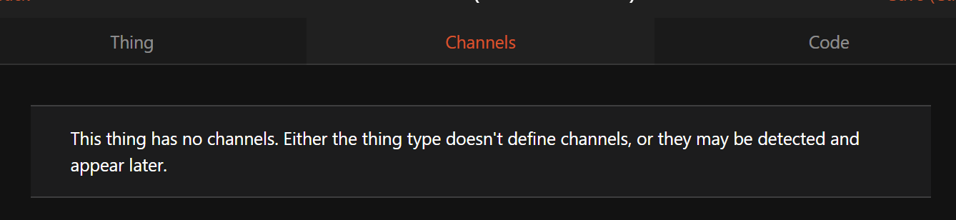

  • How can i get Neo Coolcam zwave PIR sensor working in OpenHab?

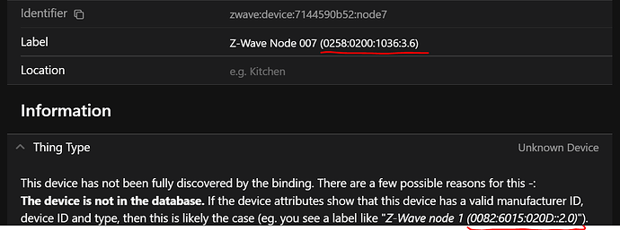

Please post a screenshot of the ‘Thing Properties’, e.g.
The device ID is (decimal):
zwave_manufacturer:zwave_devicetype:zwave_deviceid:…
Series 700 devices and Series 500 controller should be compatible (Z-Wave HW platform of your sensor is ZM5202).

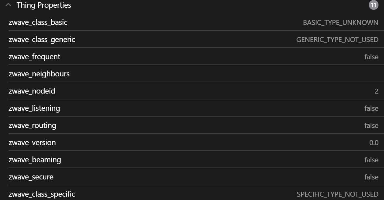

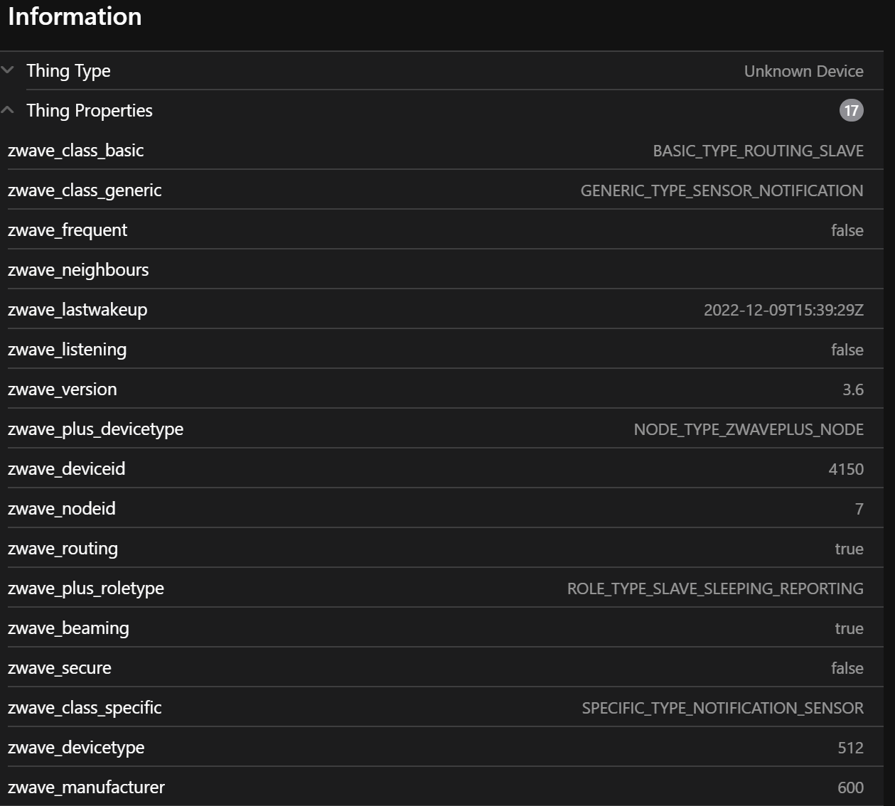

This is a screenshot of the thing properties of the PIR device. It looks totally different then your screenshot.

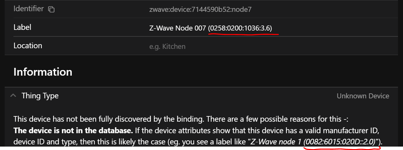

Maybe this is usefull as well

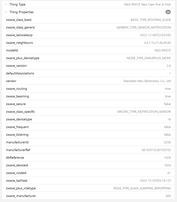

The thing settings of my neo wall plug switch do look like your screenshot
Well, several parameters are missing from the Thing Properties, which is a clear indication that the interview of your device wasn’t successful/completed.
Without more data from the interview (or a debug log), I can only give general advice:

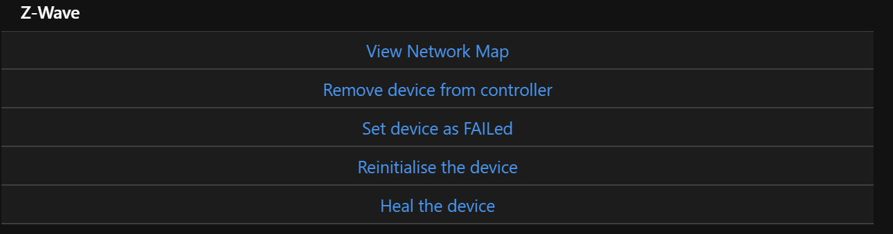

I dont have those options, i only have these for the PIR device:

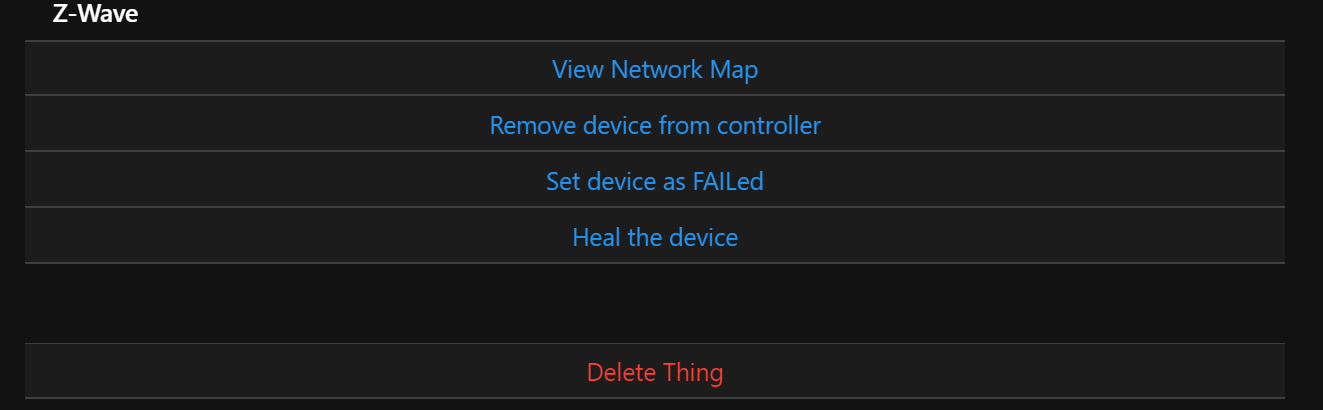

I do have those options for my z-wave powerplug which is working properly
The five line is a quick way to check if a device is fully discovered. Another is the presence of an XML file in the openhab-userdata/zwave folder (or var/lib/openhab/zwave).
Anyway you will need to find a way to wake the device. The log above doesn’t have any debug entries (Edit: plus that looks like the event.log folder, not the openhab.log)? Once the device is fully discovered, it will either work (All channels) or show the device numbers (TYPE:ID) necessary to add it to the DB. My suggestion is to keep at the button (one, three, press for a second, (be creative)) with 10 second rests until you see the five lines or you have a blister on your finger :wink:.

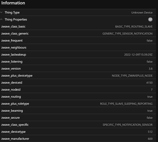

You are right, i had the wrong logs! Here the correct one (since adding the found device)

I placed a non-powered USB-hub (as i still dont have a powered one, will get one this weekend). With the hub i find the PIR device twice, once as NODE2 and once as NODE7. Node 7 looks already better, it has more device properties, including a zwave_lastwakeup which is updated when i press the button on the PIR.
I also have alle the options which i should have according to this thready here
Unfortunately i still have no chanels
I also think i have the device ID which is needed to check if the device is in the database but i’m not sure about this:
I use a RPI4 and a Z-stick Gen5 so i will defenitely try an powered USB hub when i bought one this weekend. I already use a 3A power supply :wink:
Ok good. The device is in the DB, but you need to update the binding since it was added after the last stable release OH3.3. Look at the end of this thread for 2 ways to update the zwave binding. Do whatever you feel comfortable with.
You don’t need a powered hub, that is optional. I like the powered one because I believe it provides a more even power to the antenna. (If the pi gets busy there could be a dip on the USB). I could be wrong as I am not an expert.
… and I strongly recommend using a USB extension cable between your USB hub and your Z-Wave stick to reduce EMI.
Thanks for your support, got it working with the new binding. Now it works out of the box like expected!.
