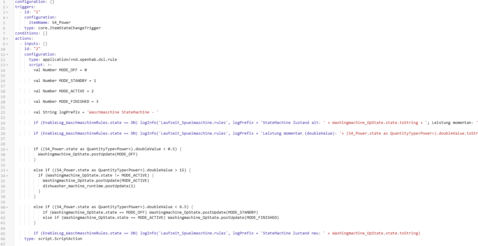

Code:
configuration: {}
triggers:
- id: "1"
configuration:
itemName: S4_Power
conditions: []
actions:
- inputs: {}
configuration:
type: application/vnd.openhab.dsl.rule
script: >-
val Number MODE_OFF = 0
val Number MODE_STANDBY = 1
val Number MODE_ACTIVE = 2
val Number MODE_FINISHED = 3
val String logPrefix = 'Waschmaschine StateMachine - '
if (EnableLog_WaschmaschineRules.state == ON) logInfo('Laufzeit_Spuelmaschine.rules', logPrefix + 'StateMachine Zustand alt: ' + Washingmachine_OpState.state.toString + '; Leistung momentan: '+ S4_Power.state.toString)
if (EnableLog_WaschmaschineRules.state == ON) logInfo('Laufzeit_Spuelmaschine.rules', logPrefix + 'Leistung momentan (doubleValue): '+ (S4_Power.state as QuantityType<Power>).doubleValue.toString)
if ((S4_Power.state as QuantityType<Power>).doubleValue < 0.5) {
Washingmachine_OpState.postUpdate(MODE_OFF)
else if ((S4_Power.state as QuantityType<Power>).doubleValue > 15) {
if (Washingmachine_OpState.state != MODE_ACTIVE) {
Washingmachine_OpState.postUpdate(MODE_ACTIVE)
dishwasher_machine_runtime.postUpdate(1)
else if ((S4_Power.state as QuantityType<Power>).doubleValue < 6.5) {
if (Washingmachine_OpState.state == MODE_OFF) Washingmachine_OpState.postUpdate(MODE_STANDBY)
else if (Washingmachine_OpState.state == MODE_ACTIVE) Washingmachine_OpState.postUpdate(MODE_FINISHED)
if (EinbleLog_WaschmaschineRules.state == ON) logInfo('Laufzeit_Spuelmaschine.rules', logPrefix ,+ 'StateMachine Zustand neu: ' + Washingmachine_OpState.state.toString)
type: script.ScriptAction

I think the Input is the problem, my input is an energy measurement plug, and the item is declared as “Number”.
Can anyone here give me a hint on that?
