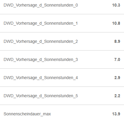

Sitemap looks OK:
So I still don’t understand that error :confused:
