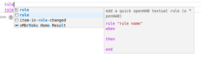

And you don’t have to type out most of the Rules DSL boiler plate anyway. If you are using VSCode, kuba added a lot of code snippets (including a lot of the Design Patterns) so you don’t have to type them.
