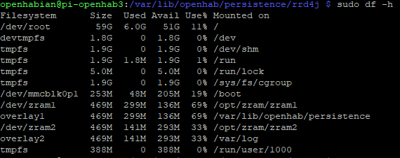

Seems like the file system really is read-only:
Doesn’t seem to be full (yet):
Is this another SD card failing or what else could be the problem here?

This may be a zram problem, what is the output of zramctl if it is what I think it is then all you have to do is simply uninstall and reinstall zram as it was a bug in the code that has since been fixed.
Thanks for looking into this. Output is:
Uninstall/reinstall: sudo apt-get remove zram // sudo apt-get install zram ?
Hmm, it may be the problem I’m thinking of. Go ahead and try uninstalling zram and reinstalling. You can use sudo openhabian-config menu option 38 to do so. As a secondary debug step, what does your RAM usage look like?
After a reboot, RAM usage is now:
After uninstall:
After new installation:
After a reboot:
It it supposed to look like this now?
The reboot seems to have fixed the error from appearing (for now?).
Yes, that looks correct. Hopefully it will be fixed forever now.
