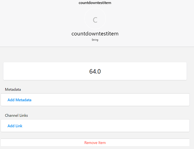

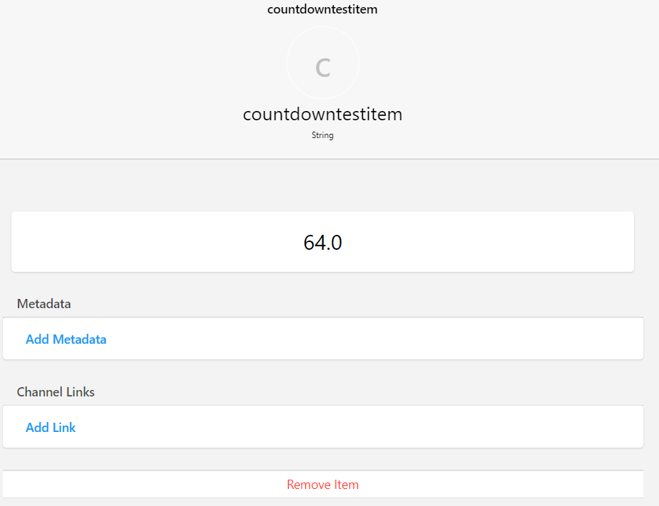

One thing I don’t get, is why countdowntestitem displays the time in 0.0 (seconds):
I would expect the HH:MM:SS format, based on this: openHAB Rules Tools [4.1.0.0;5.9.9.9]?
I got it to MM:SS format through the stateDescription metadata (%1$tM:%1$tS):
