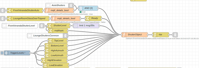

I am currently using node-red for my rules on OH2.3.
I am working on trying to redo my rules for OH2.4 but it is a very big job and I know this can be improved greatly.
Below is the section of the flow that handles the front shutter, I hope it helps.
It takes into account whether automation is turned on, the air conditioner state, THI inside and outside, temperature thresholds, day/night, weather forecast, position of the sun elevation and azimuth (high and low for each to provide the limits), a high and low level for the open positions and whether the door it covers is open or closed. It collects the variables as they change and waits until it has all before it does anything.
The code is:
