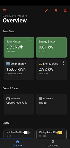

Just need to now some how display these states as colors in MainUI so I can color the tiles correctly.
Screenshot_20210927-101039_openHAB
All that is here:
Yep just working through it :slight_smile: having issues with negative values , ill sort it out!
Try multiplying those by -1 as well.
