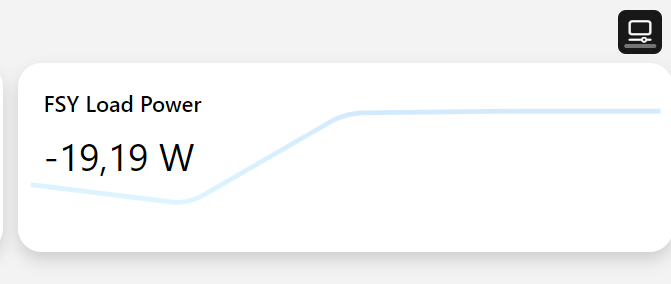

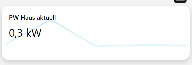

As a beginner I am not shure about the use of units.
I try to integrate a Powerwall and an inverter of different companies (Tesla Powerwall, Fronius Symo):
Using your example:
logInfo("PW", "PW_Haus: " + PW_Home.state.toString)
logInfo("FSY", "FSY_Load: " + FroniusSymoInverter_LoadPower.toString)
gives
2021-02-28 19:56:25.405 [INFO ] [org.openhab.core.model.script.PW    ] - PW_Haus: 0.30129491788679763 kW
2021-02-28 19:56:25.424 [INFO ] [org.openhab.core.model.script.FSY   ] - FSY_Load: FroniusSymoInverter_LoadPower (Type=NumberItem, State=-11.78, Label=FSY Load Power, Category=, Tags=[Point])
So: If I want to work with these I have to convert both to numbers, multiplying the PW power by 1000?
I understand the output of PW_Home in the UI with unit kW, how does the UI know that
FroniusSymoInverter_LoadPower hast to be display with the unit W?
