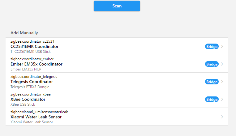

Can you tell me how you did this? I have a HUSBZB-1 that I was using for HomeAssistant. However, OpenHab does not seem to have this as an option
When I go to add a Zigbee Bridge, these are all that pop up
I believe the HUSBZB-1 is based on the Ember EM35x.
Thanks, that eventually worked (with a reboot)
I have the HUSBZB-1 “online” using the Ember EM35x Coordinator
  • Port: /dev/ttyUSB1
  • Flow Control: Hardware (CTS/RTS)
  • Baud Rate: 57,600
