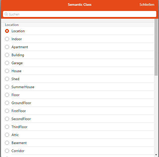

hi, ok, need to specify my question:
when adding a new location to the model, I can name a Room whatever I want. but from the semantic class selection I`m limited to the predefined ones from that list:
Is it possible to add custom semantic classes?
if not, what are the implications later on if I have multiple Rooms of the same semantic class “Room”?

Short answer: you can not modify the semantic classes
Little more details: as far as I followed this discussion the classes are hard-coded in a core package and also in the UI. There was a pull request to add several new classes merged just before the release of Oh3. A lot more classes were added.

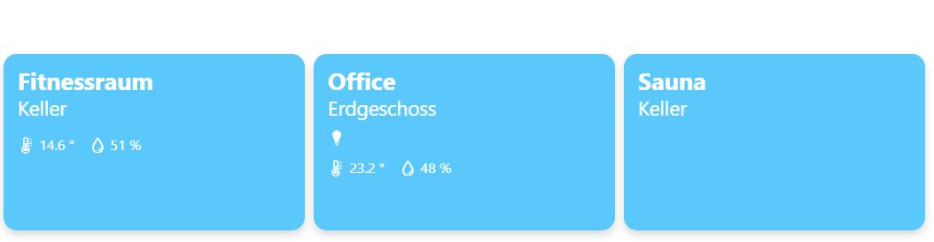

thanks. I created 2 rooms in my cellar, both have semantic class “Room” and the location cards look good:
so what is the advantage of having separate classes like “livingroom” or “bedroom”? is it somehow related to HabBot or do they make life easier if using them in combination with Alexa?
