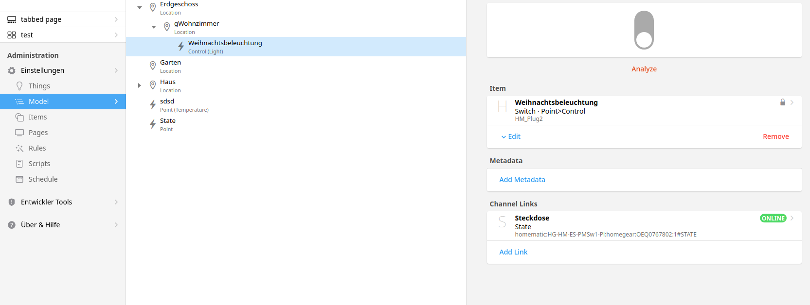

This is part of an *.items file.
Group gErdgeschoss "Erdgeschoss" ["Location"]
Group gWohnzimmer (gErdgeschoss) ["Location"]`
Switch  HM_Plug2                    "Weihnachtsbeleuchtung"   (gWohnzimmer) ["Light"] { channel="xx" }
It automatically translates to this in thesemantic model :
So the switch HM_Plug2 is now part of the Semantic Model. Important: it needs a “semantic class” the ["Light"] in my case in addition to the group, also the group needs a semantic class. in my case "Location"]
This might help you as well @Scuby
