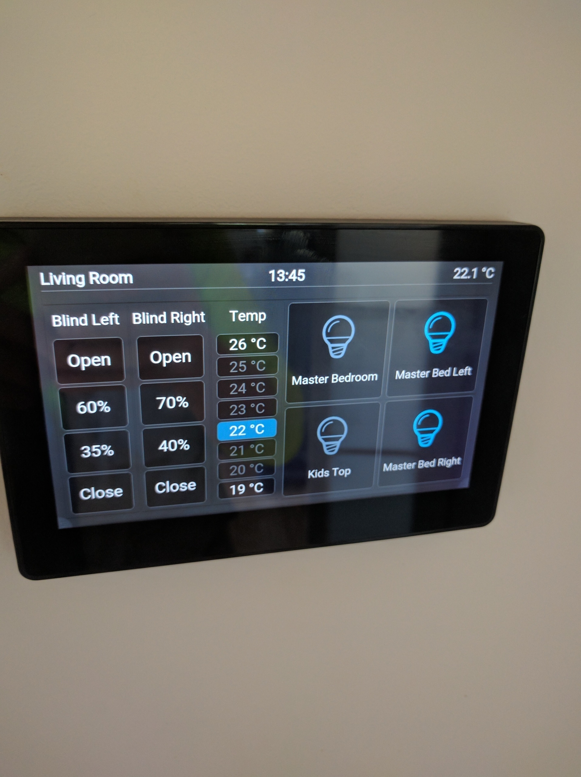

Here is a larger size slider replacement I call a Thermostat that is based on the roller/dimmer i did before. With 8 custom setpoints, accents on the end of the scale and feedback on the currently selected value.
It would be nice if someone who actually can code would make it into fully customizable widget that would allow setting. the number of displayed buttons.
Thermostat.widget.json (15.3 KB)

I have a suggestion, too:
How about linking another item to show what the actual temperature is? For example, The room has 20 C and I set the thermostat to 22 C, the 22 C is highlighted. Can I also have the 20 C highlighted (with another color, or border color)?
What do you think?

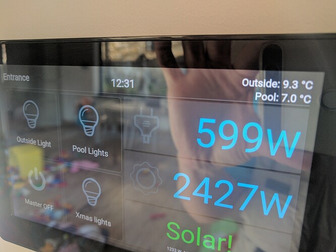

Here is the code.
<div
        style="
               position: absolute;
               background: rgba(0,0,0,0);
               top: 15px; width: 100%;
               height: 60px;
               border-width: 0px 0px 1px 0px;
               border-style: solid;
               border-color: #666666;
               font-size: 2.3em;
               font-family: Roboto, Helvetica, sans-serif;
<div class="row" style="font-weight: bold;
                        color:#cccccc
  <div class="col-md-4" style="top: 2px" >Entrance </div>
  <div class="col-md-4" style="top: -3px">
    	<div ng-init="clockmodel={
                'mode':'digital',
                'font_size':24,
                'digital_format':'HH:mm',
              }"><p class="text-center"><widget-clock ng-model="clockmodel" style="padding: 0px;" /></p></div></div>
  <div class="col-md-4" style="top: -4px; font-size: 24px;">
    <p class="text-right" style="-webkit-margin-after: -2px;"> Outside: {{'%.1f °C' | sprintf: itemValue('G_Temperature_t2q_Gardenbox')}} </p>
    <p class="text-right" style="-webkit-margin-after:  0px;"> Pool: {{'%.1f °C' | sprintf: itemValue('G_Temperature_wn8_pool')}} </p>
    </div>
</div>
</div>
Sorry, my explanation was pretty unclear. I was specifically asking about the 8-point thermostat mentioned in your original post.
There, your temperature setpoint is highlighted with a blue bg-color.
Now let’s assume the Living Room has 20 C, instead of 22.1 C. I would like to have blue border color around the 20 C button, and a solid bg-color around the 22 C setpoint.
But thinking about it, this could be possible using anything like ng-style or ng-if, right?
that is quite a good idea, you can make it with some more conditional formatting the same way I do the background highliging.
Or I have another version of this widget designed for 3 panel width that has some more padding on both sides of the buttons. So there would be space on the side to put a little color changing arrow marker “>” that would move up and down and show how far the current temp is from target setpoint.
I think I will try to do the second option as soon as I will finish the fight with the heating valves rules.

Oh cool. A tiny tiny triangle on the left or right or both sides (configurable?) would be very cool as well. And much more precise than the border highlight, but at the cost of cleanness.
