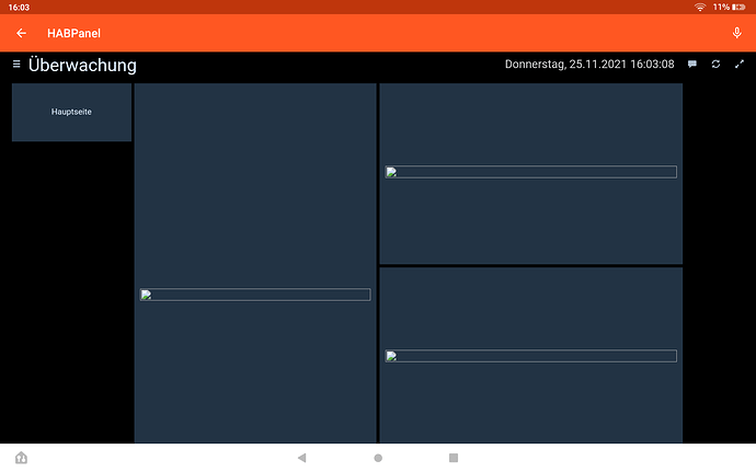

I am using your widget. As mentioned in another thread I am able to see the cam pics if I am using the browser.
Using the openhab app on my tablet I am getting errors like below.
Screenshot_20211125-160310
Do you have any clue why this happens?
When you use the app is is connecting locally or through the cloud? Also keep in mind that it may not be smart to setup habpanel as OH3 is moving in a new direction and does a similar/same thing in a new way. Best to invest your time in the newer ways as they will be supported longer into the future.
