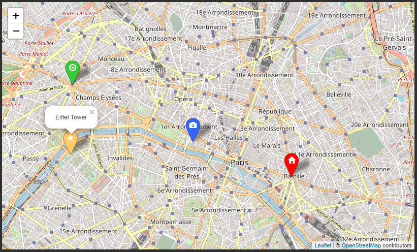

Custom Widget: Map
This widget will display up to 6 markers on an OpenStreetMap map, positioned by openHAB Location or String items, with configurable colors/icons and real-time updating when the underlying items’ states change. The labels of the items will be displayed in a tooltip when clicking on a marker.

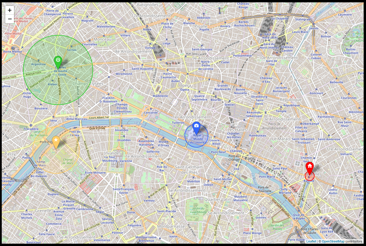

I do have a few suggestions for added features:
  1. Automatic zoom (to a definable max level if all markers are at the same location) to fit all markers.
  2. Possibility to add location accuracy rings for the pins (I don’t know if many bindings provide the data, but the iCloud binding at least does so.
    And finally maybe change the order of lat/lon in the config.
I would also think, these two suggestions would be a huge benefit for the widget!
Actually wasn’t too hard - done.
You need to update both the widget in HABPanel and pull the changes from the repository; I updated the Readme in the repository with update instructions. You can open it with the “Help” button in the widget settings or the context menu (“Open Help”) in the custom widget’s list.
Excellent! Works perfectly on Edge and Safari. For some reason Chrome doesn’t render the circles, but for me that’s not an issue.

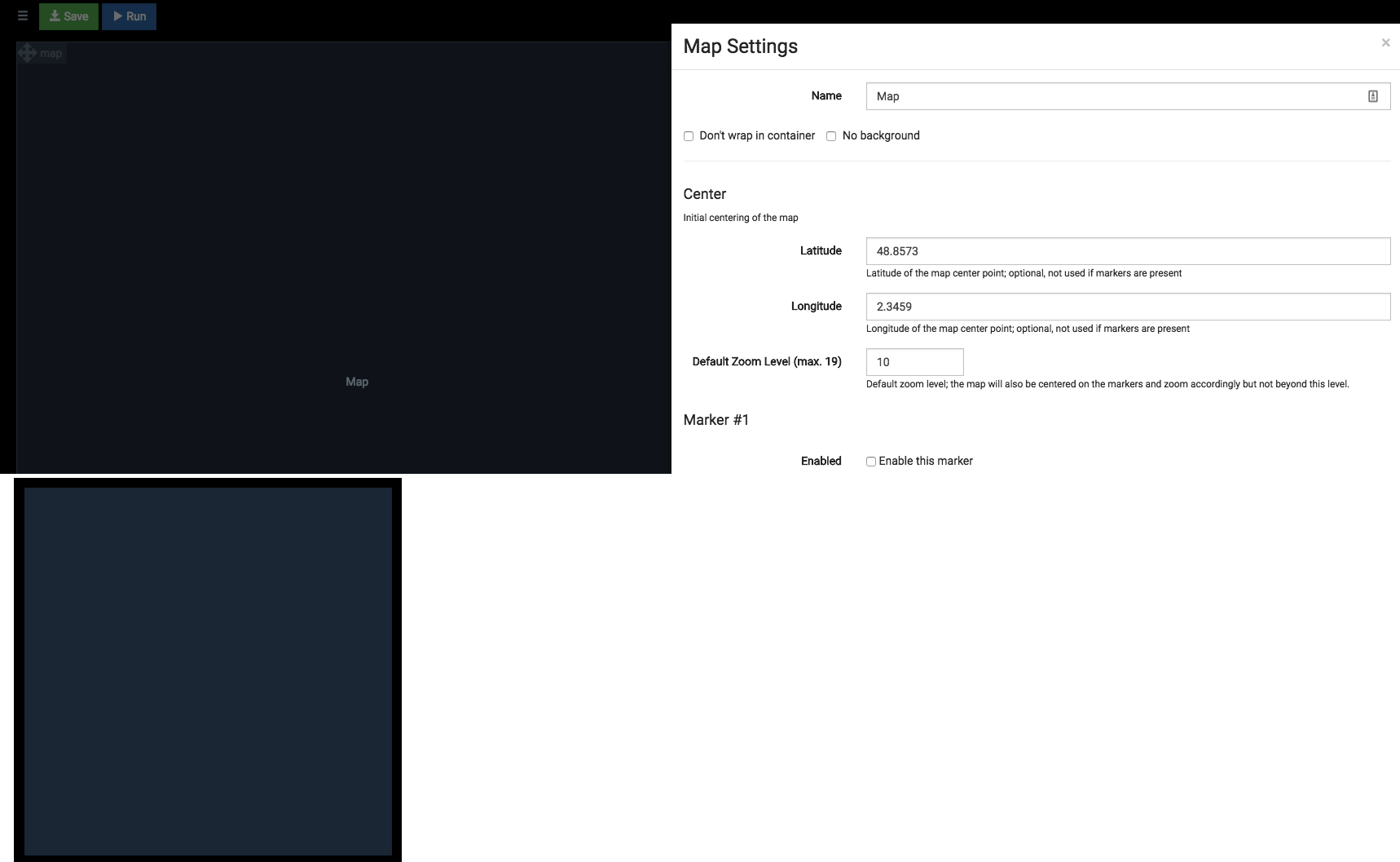

Hi, I’m new to openhab, the map widget is exactly what I’m
looking for, but it is not working. Maybe someone can help me. I’m running openhab 2.2.0.010.
Installed it with the green import widget button. I can add and place the widget, go to the edit menu but after save and run in the habpanel. i only see the blue square and no map. :frowning: .
Any idea what i did wrong?
Thank’s Kai
same with me, Kai.
Have you been able to solve it?
EDIT: Stupid me :wink:
I should have read thoroughly the installation process and missed this part.
cd /etc/openhab/html
git clone https://github.com/ghys/habpanel-map-widget
Sorry for that.
