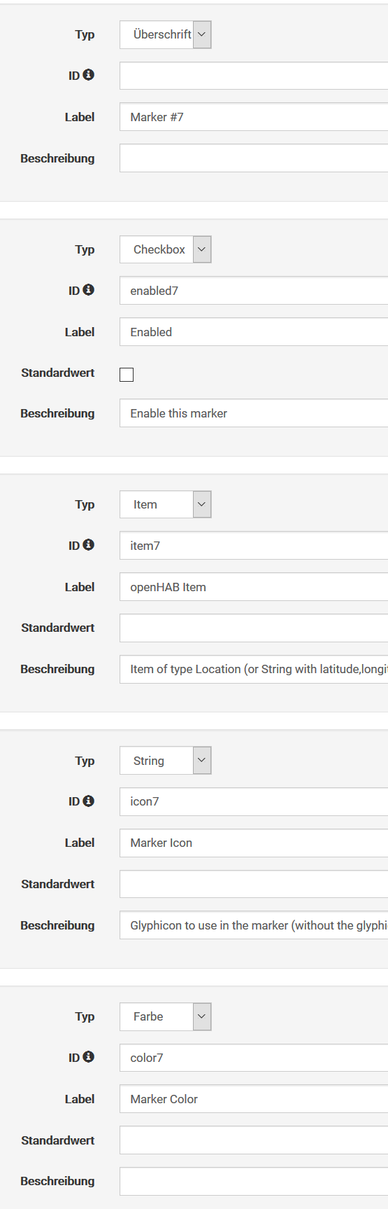

However @ysc :slight_smile:
I changed the widget and added a 7th Marker (and removed the accuracy stuff, which I don’t use).
The 7th Marker will not show up though.
Is there anything else I need to change beside this:
EDIT I:
I guess I found it in map.controller.js
r (var i = 1; i <= 6; i++) {
and will mess it up a little :wink:
EDIT II:
Yes, works like a charrm with “7”
