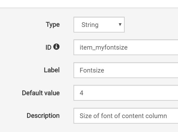

There is a code sections, a settings and a preview section. To start simple I added a new parameter called “item_fontsize” at the end. At the moment I do use the widget “Showvalues_ON” section to display the status of my windows.
So I quickly changed your ON/OFF to my windows sitecode mapping table “OPEN/CLOSED”. THAT works already.
Then I changed your hardcoded font-size: 16px to → (config.item_fontsize + “px” ). My assumption was that If now go to config the widget and change the value of the fontsize parameter that the font would change. But it doesn’t.
I saved, refreshed the browser, deleted and re-added the widget on the dashboard but could not get this to work.

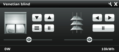

is there a way to use this for venetian blinds (raffstore) by controlling the blind (open/close) and blade position?
like
@shorty707 The Widget is creating a table in html - this is far off from the layout you are looking for.

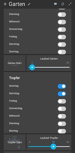

I’m using a custom widget that’s based on this one and since some time i have a problem with the order of my items…
i have three different groups with items like this:
Group WTx:
WTx1 Monday
WTx2 Tuesday
WTx3 Wednesday
WTx4 Thursday
Group WTy:
WTy1 Monday
WTy2 Tuesday
WTy3 Wednesday
WTy4 Thursday
items are listed exactly the same way in file.items
last year the items where listed correct in 3 different multi-state widgets, but now i have one widget with the correct order and two widget with “an alternative” (=wrong) order. already tried to restart openhab and to delete/re-add the widget, but it remains the same. Here’s what it looks like:
first part is correct (“Montag” is not visible / outside screen), second part with alternative order. below is a third widget - with a different order again.
has this happened to anyone? and: how can i fix this?
