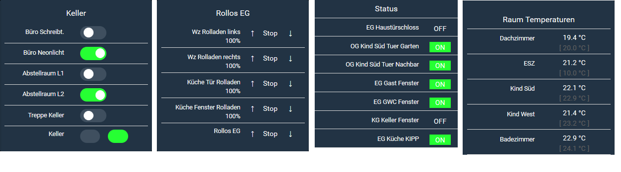

For all my items I could not find one widget, that displays the items plus values of one group. I also wanted to offer to change all of them at once and I wanted to have more transparancy in my heating and rollershutters etc etc.
The side condition was: No global css - everything should run out of the box.
So I started to work on this widget.
Please find attached the possibilities how to use this widget in the picture, plus the widget itself.

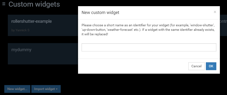

*.widget.json files are only for exporting/importing purposes, it’s not recommended to edit them.
After importing it use the code editor embedded in HABPanel.
Then how are you supposed to create new custom ones?
With the “New widget” button?
Please refer to http://docs.openhab.org/configuration/habpanel.html#custom-widgets
Right… I didn’t know about the built-in editor… Thanks for that. Sometimes it take a small blunt instrument.

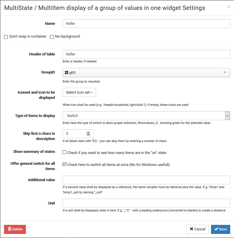

The second value for references how can i use it?
Hi!
"If a second value shall be displayed as a reference, the name variable must be identical plus the value. E.g. Temp1 and Temp1_soll by naming “_soll” "
The trick is in the variable name itself.
Your need the
Number Temp1
and
Number Temp1_soll
By adding the “_soll” into the field, the Temp1_soll is automatically found and displayed in parallel to the Temp1.
Michael

I like this widget and its working in principle for me. However one question . On your initial pictures in this post you do have illustrated nice little “green” boxed with white text as information for “ON” .
I Do use “Open” and “Closed” as mappings in my sitemap. How can I configure that I do get this color separation too? At the moment its just showing the “Text”
Many thanks for an answer
Hi!
This is hard coded to match ON/OFF …
