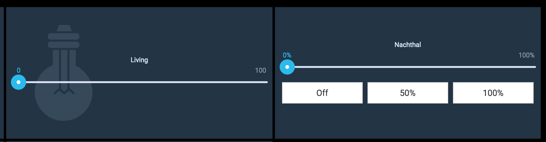

I am using this widget for dimmers to provide full range control using the slider and quick access to commonly used levels with the presets. Before creating this, I was grouping standard slider and button widgets as shown in the right of the screenshot below. The left and bottom of the screenshot show a couple example configurations of the widget.
Slider with presets examples
The CSV list can be just the values which will be used for the button text and the value written to the item as shown in the bottom of the screenshot. CSV: 0,25,50,75,100
The CSV list can also contain value/text mappings as shown in the left of the screenshot. CSV: 0=Off,50=Half,100=Full

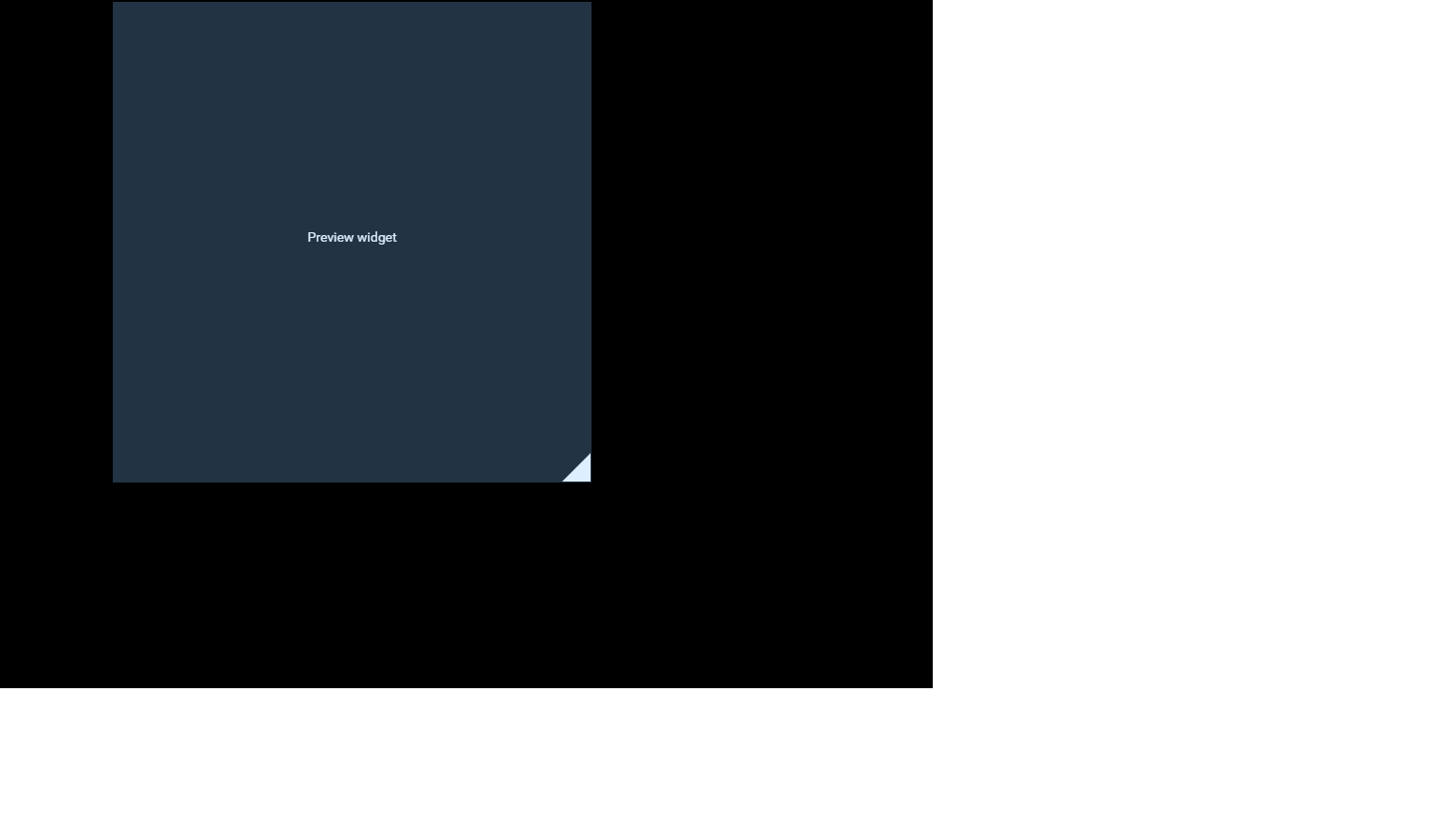

How did you implement it to openhab when i select the widget it shows me preview widget with a blue background

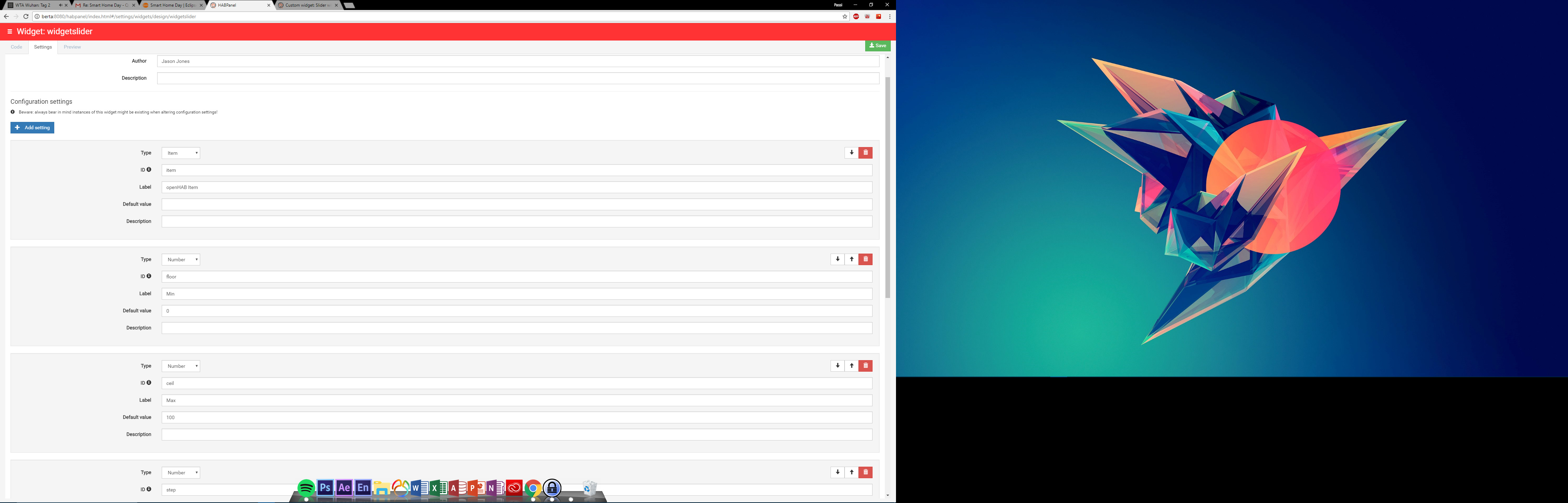

I still have issues my openhab is on 2.2 right now

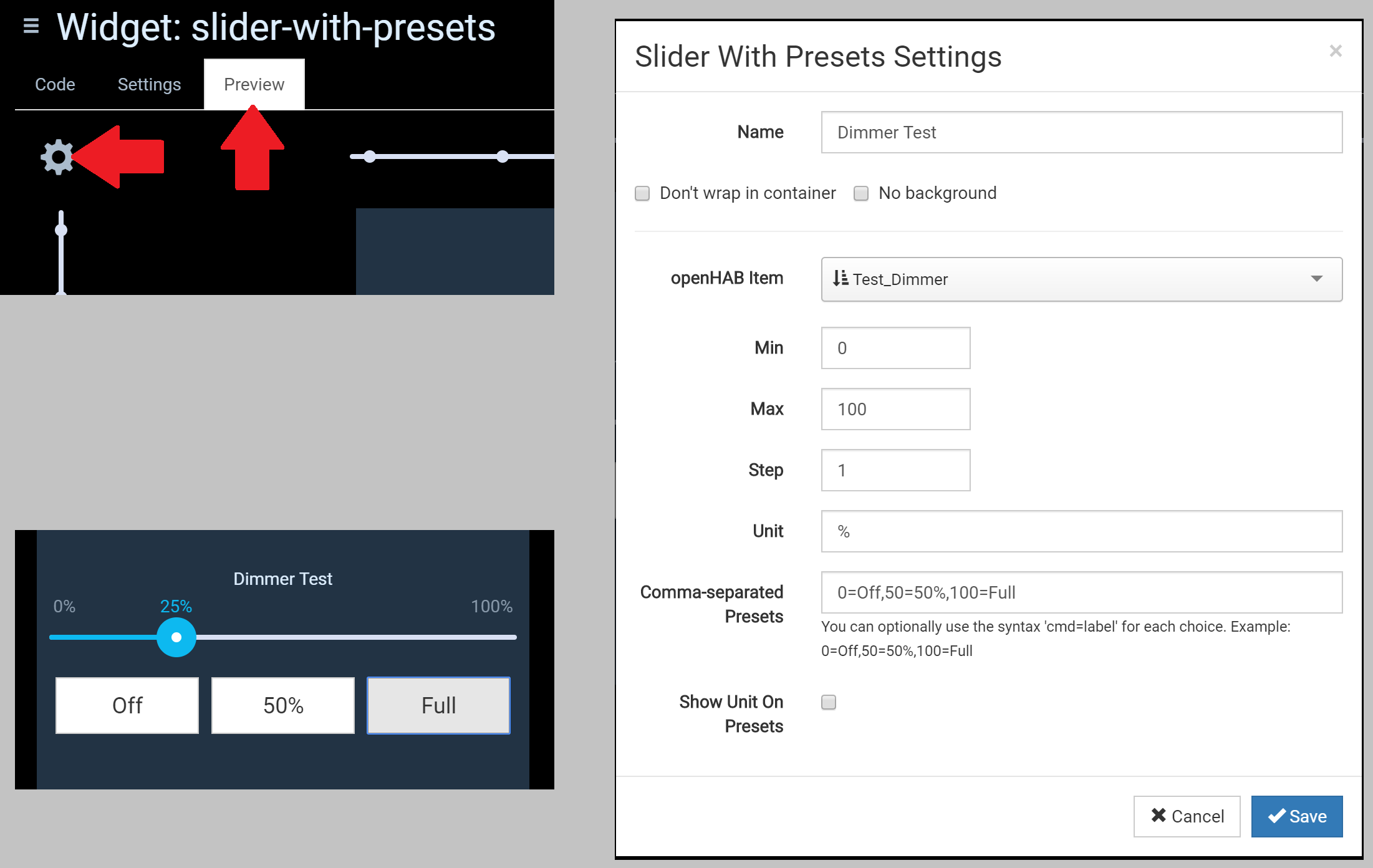

The image above shows the tab used to create the settings. We need to make sure the settings are being set to real world values using the “Preview” tab.
In the image below:
  • Top left is how you access the settings
  • Right shows example settings
  • Bottom left shows the result
Keep in mind that the “openHAB Item” should be set to an item of a type that is compatible with a slider. (Number or Dimmer)

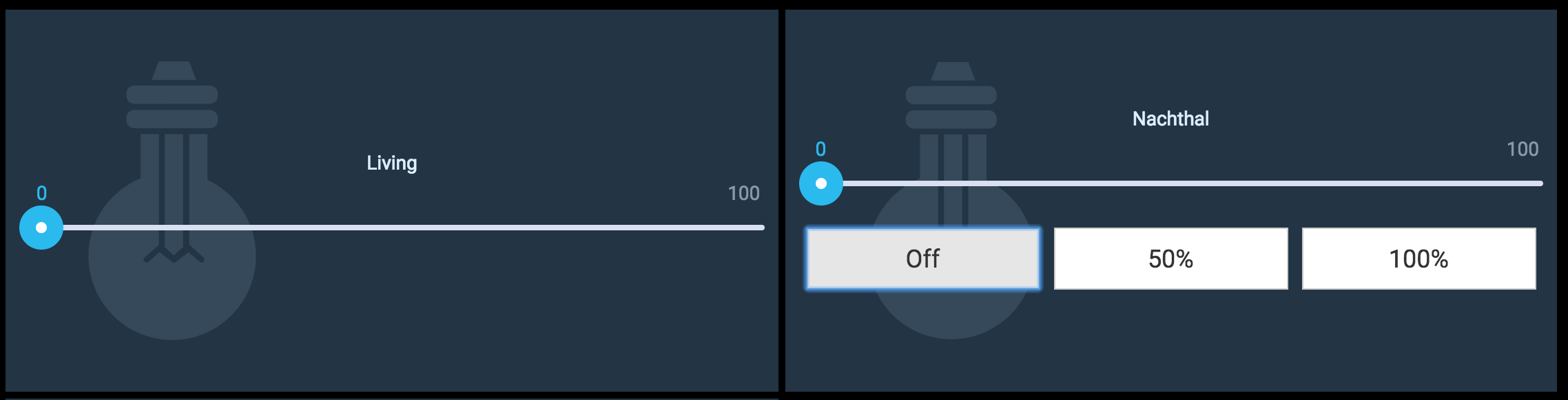

@jjones Love this widget. One question though, what would it take to add a background image to this widget?
Below an image of the regular slider in my Habpanel and your slider with presets. Would be great if I could add the lightbulb in your slider as well, even if just manual
I have updated the widget to support a background image. The GitHub repository (in the first post in this topic) has been updated with the new version.
@rswennen, please test this version and verify that it is working as you expect.

@jjones tested it and works great !!! Thanks a lot.
