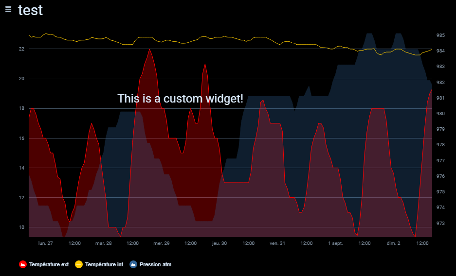

@tailor See here, section “Reuse built-in widgets”:
In all theory you can spawn a chart with <widget-chart ng-model="..."></widget-chart> and extracting the model from an existing chart with the “Edit the local panel configuration” technique as described, however the charts are one of those widgets types like the knob which adjust their size automatically, so it’s more difficult to have it positioned correctly, you may have to tinker a bit.
It works with a set of 3 divs with absolute positioning:
<div style="position: absolute; top: 0; left: 0; width: 100%; height: 100%">
	<div
       ng-init='model=                {
                    "name": "Température",
                    "sizeX": 12,
                    "sizeY": 6,
                    "item": "Outside_Temperature",
                    "type": "chart",
                    "row": 6,
                    "col": 0,
                    "charttype": "interactive",
                    "service": "rrd4j",
                    "period": "W",
                    "axis": {
                        "y": {
                            "includezero": false
                    "series": [
                            "axis": "y",
                            "display_line": true,
                            "display_area": true,
                            "name": "Température ext.",
                            "color": "#FF0000"
                            "axis": "y",
                            "display_area": false,
                            "item": "MultiSensorSalon_Temperature",
                            "name": "Température int.",
                            "color": "#FFCC00"
                            "axis": "y2",
                            "display_line": false,
                            "item": "Outside_Pressure",
                            "name": "Pression atm.",
                            "color": "#336699"
      <widget-chart ng-model="model"></widget-chart>
      <h3 style="position: absolute; left: 25%; top: 25%">This is a custom widget!</h3>
    </div>
  </div>
</div>

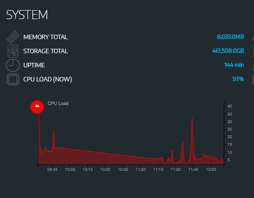

@ysc Hi Yannick
Thank you very much. I tried to implement the chart in a widget based on the Matrix template.
Selected Code
<div class="widget">
	<div class="graph">
         <div>
			<div
             ng-init='model=                {
                    "name": "CPU Load",
                    "sizeX": 12,
                    "sizeY": 6,
                    "item": "num_sysinfo_cpu_load",
                    "type": "chart",
                    "row": 6,
                    "col": 0,
                    "service": "rrd4j",
                    "period": "4h",
                    "axis": {
                        "y": {
                    "series": [
                            "axis": "y2",
                            "name": "CPU Load",
                            "legend": false,
                            "color": "#FF0000"
				<div style="width: 100%; height: 250px">
				</div>
			</div>
		</div>
	</div>
</div>
The resulting chart looks like this:
That a good initial result :grinning:
  1. Would it be possible to hide the legend (btw. why ist it on top of the chart?)?
  2. How about adjusting the size of the text?
  3. Any other adjustments?
Thank you very much in advance.
You can probably do all of those things with CSS. Can’t check now but the basic idea is to use the “Inspect” feature of your browser to figure out CSS classes and add CSS rules like display: none to hide the element or font-size to change the text size.

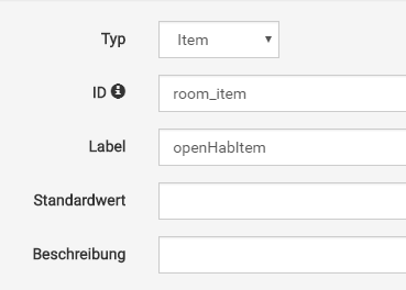

I try to build my own widget so I can use it for all my lights.
I have created a placeholder for an item under Settings. When I later assign an item to the widget, the name is displayed instead of the value of the item.
Actually the value ON or OFF should be in the widget?
If I use the standard widget “Switch” then it works.
What am I doing wrong?
Code:
<div ng-if="itemValue('config.room_item') === 'OFF'">
  <i ng-click="sendCmd('config.room_item', 'ON')" style="font-size:30px;" class="fa fa-lightbulb-o" aria-hidden="true"></i>
 </div>
{{config.room_item}}
{{config}}
<div ng-if="itemValue('config.room_item') === 'ON'">
  <i ng-click="sendCmd('config.room_item', 'OFF')" style="color:yellow;font-size:30px;" class="fa fa-lightbulb-o" aria-hidden="true"></i>
 </div>
Remove the quotes around 'config.room_item'
