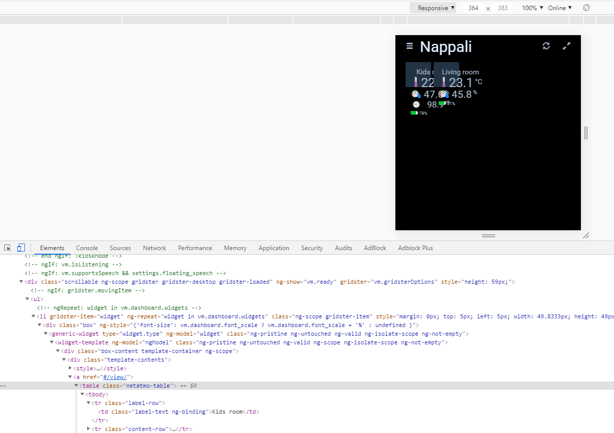

I have created two custom widgets for my Netatmo weather station.
Here is a screenshot of them:
The Netatmo widget can be used for main, indoor and outdoor module.
You can show the value for CO2 or pressure. If you want to show the pressure you have to select a non numeric item (e.g. switch) for CO2, if you want to show CO2 you have to select a non numeric item for pressure.

Hi guys,
I’m trying the netamo widget in habpanel. It is working well, but does not look very nice on mobile devices. It seems, that the font scaling is somehow not working or not handled. Any thoughts on it?
Thanks!
