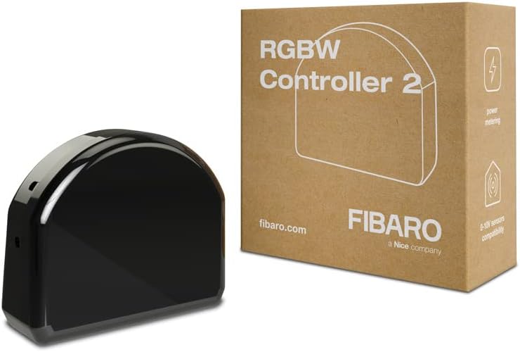

My best suggestion would be to split the tape in half, or however you want, to make use of this 4 channel controller.
I’m strictly a cabled guy, so I’m out of ideas now :frowning_face:
But can a RGBW Controller controll a CW/WW strip?

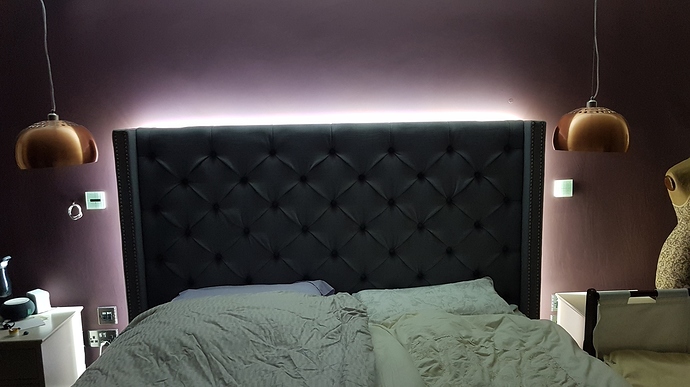

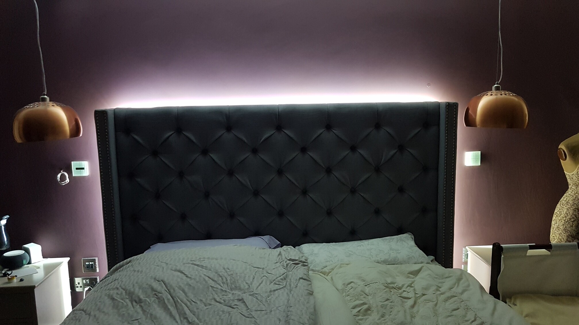

I use one of these WiFi LED controllers flashed with Sonoff-Tasmota firmware to control multiple, independent, single color temp LED strips. There’s no reason you couldn’t use just the CW and WW channels for your application.
Sure you can :slight_smile:
RGBW is only 4 channels of PWM LED control. :wink:

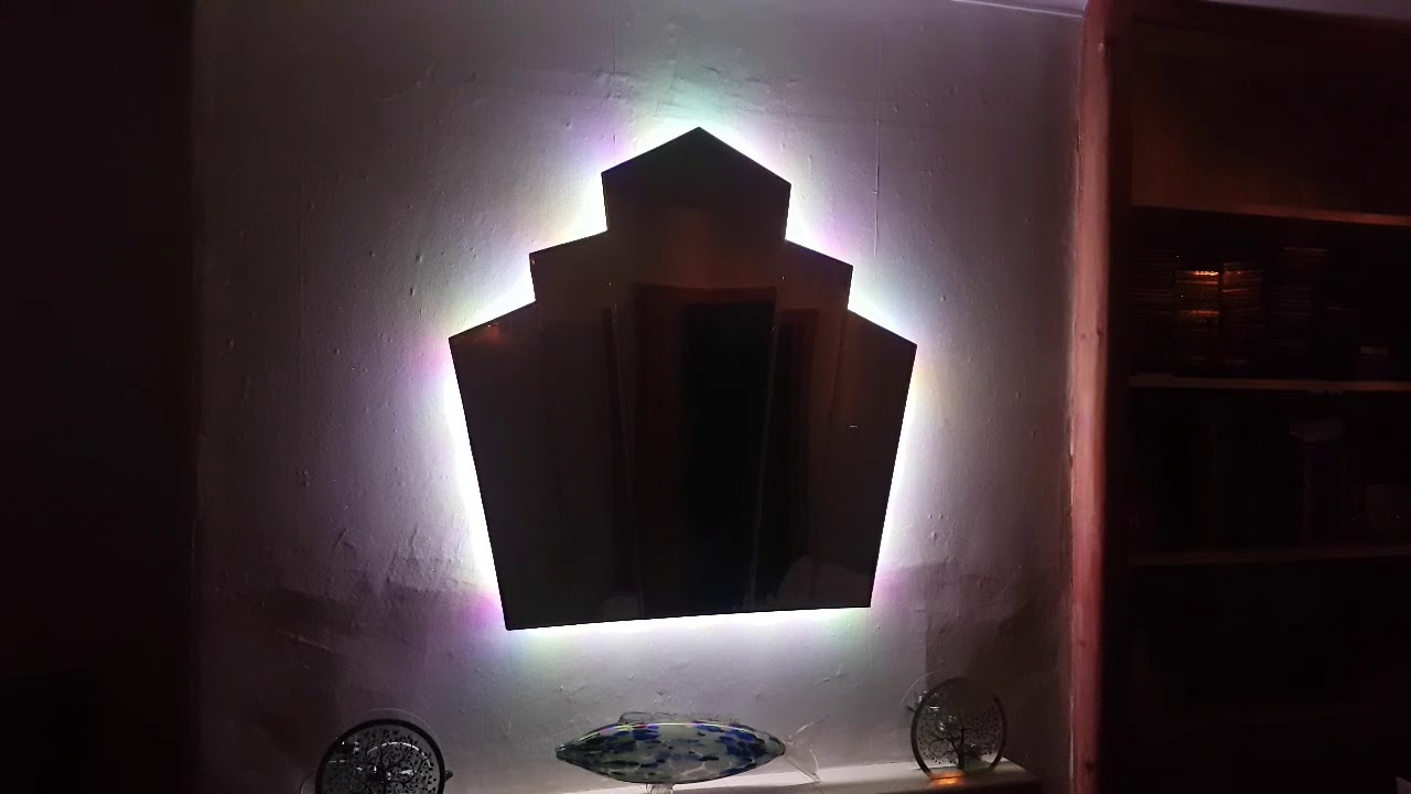

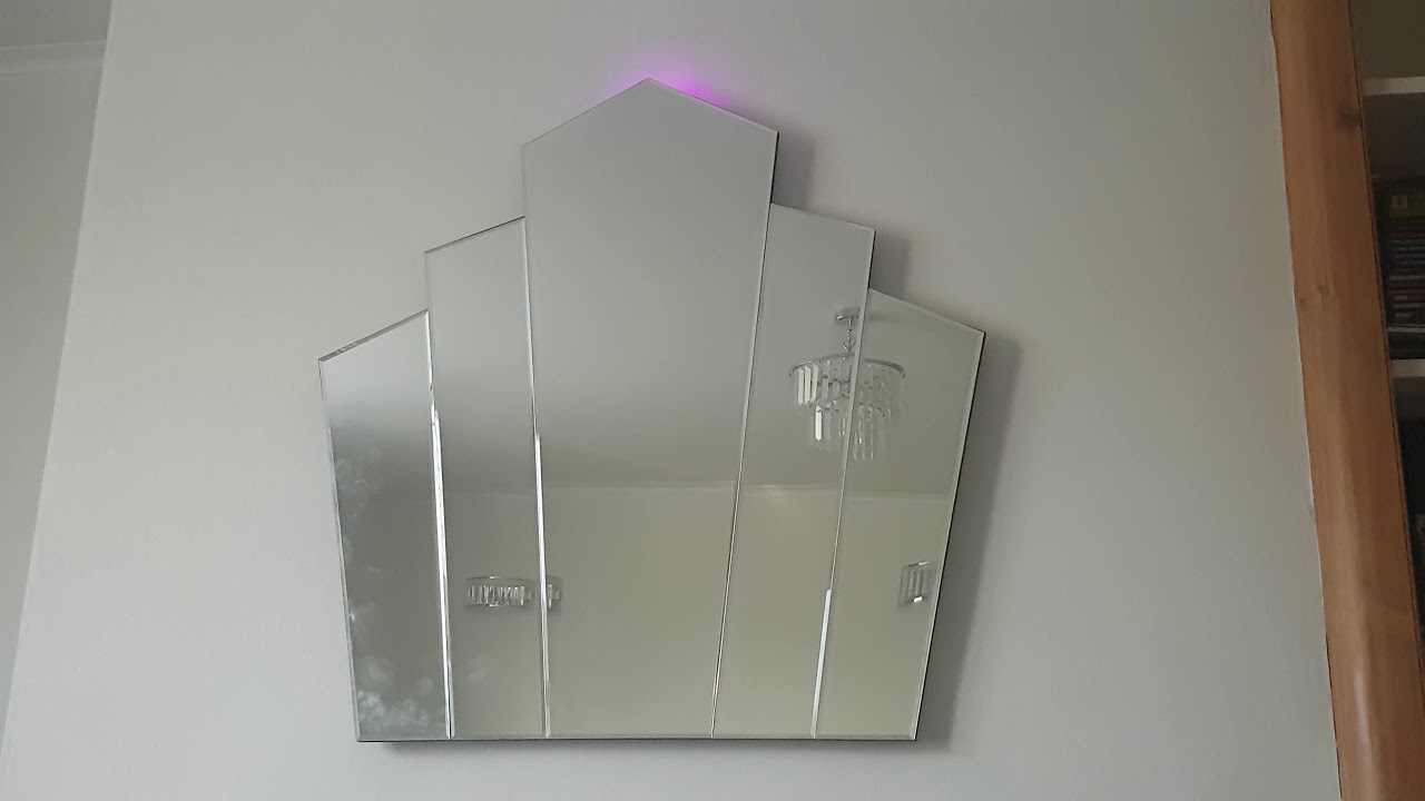

Magic Home Led controller for 10 Euro on Amazon work great with Openhab led binding. You can block internet access for the stripe in your firewall and control them directly in your Intranet. Openhab can control color, program, speed and switch on and off. No flashing required - the app is only used to connect the controller to your wlan.
