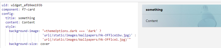

As this is standard css syntax it would be strange if it doesn’t. :slight_smile:
Are you sure that you can access these images at the given path?
It works fine here:
background

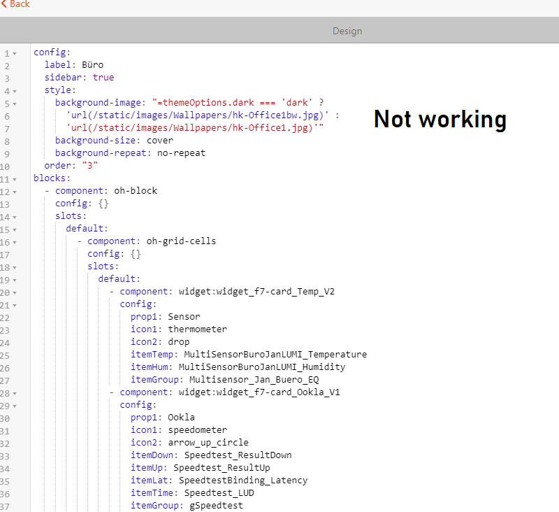

Hi Rainer,
i just replicated your little setup with an f7-card in a widget and i confirm there it works perfectly well. Where it does not seem to work is in the code of a page to change that background. Maybe this is a bug? I cannot think of something else here. If you confirm, i will create an issue log.
working
not working:
by the way how are you creating that animated gif´s ?
Ah okay, didn’t know that you’d like to change the page background with this. And yes, this isn’t possible right now due to the fact that the page can’t handle the variable informations you’ll get with = afaik. This would be a feature request in the openhab-webui repo.
Am I correct here @ysc ?
An awesome open source tool (Windows only sadly) named ScreenToGif
Hi Rainer, once again thank you for your valuable time: i did fill a feature request in the openhab-webui repro:
I can imagine that this request finds more people that would like to see this implemented as we are moving along the line of optimizing our experience with the OH3 UI, one thing i noticed is that switching from dark to light does have some downsides, but the reality is that my family at home does have different preferences and it needs to address both. Changing a background based on the dark / light theme seems to be something an obvious one.
Yes the page config cannot be evaluated as expressions right now.

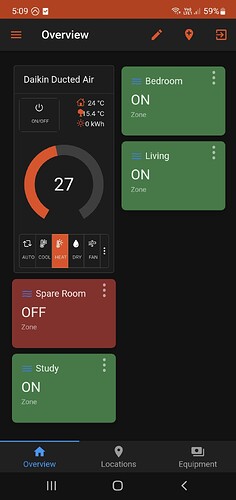

I’ve a Daikin HVAC connected to KNX via ZENNIO KLICDDv3. Here are my modifications to make this widget work. Also included, the working KNX channel configuration for DPT 20.105, DPT 1.005, DPT 5.001
See OH 3 Tips and Tricks - #18 by Fritz on how to copy this to your configuration.

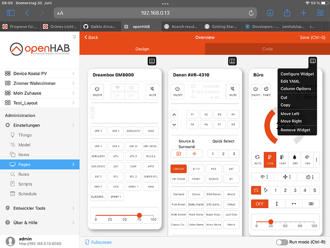

Edit Overwiev page
Click black icon right above the widget to edit the column
Column options
100%
This is the default theme color. I think you need to set --f7-theme-color to a different color.
Check the f7 documentation.
I just get details of the actual widget, nothing related to column. Do you have a screenshot?
Here you go…
Very strange, i do not have that option
When you add a row, you can then add columns. For each column you can set column options.
I think you were adding cells - I never worked with this approach so far.
ahhhh! Ok, much better :slight_smile: Works nicely now. Just need to sort out the colours. Great widget, thanks for your help
