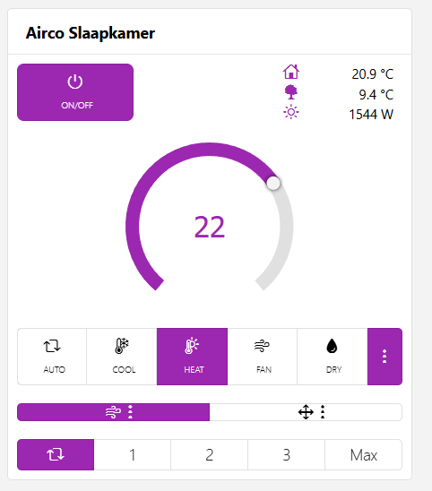

Great widget!!
Had to change it a little to make it work with items which are numbers. In my case, “AUTO” = 0 and that did not work correctly. And updated the way the temperature and solar power are displayed.
Updated code is below.
Thanks!
Matthijs
