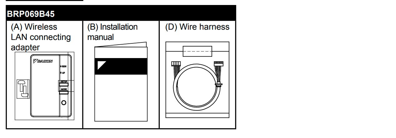

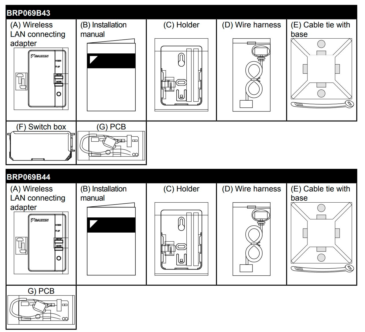

BRP069B41 is the wi-fi adapter itself. From 42 to 45 are different kits and therefore all include BRP069B41 in it. Some just have shorter cable for installation in the indoor unit, some have additional PCB for retrofitting small (20-25) units that don’t have S21 on their main board. In general all are BRP069B41, some have additional stuff included intended for specific models installation.
