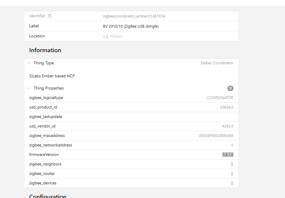

hey @chris, hey @NilsOF,
The BV 2010/10 (ZigBee USB dongle) is running on the Firmware 5.8.1.0.
I reinstalled the openHAB ZigBee Binding in the version 3.2.0 to ensure that the latest binding is installed.
Is a update required or shall I proceed to collect the debug logs?
This is very old firmware. For ZB3.0 devices, you need a version newer than 6.4 if my memory serves me correctly (it’s in the OH ZigBee binding docs, but I think this is correct).
Okay I will do an update and let you know if it solves the problem
