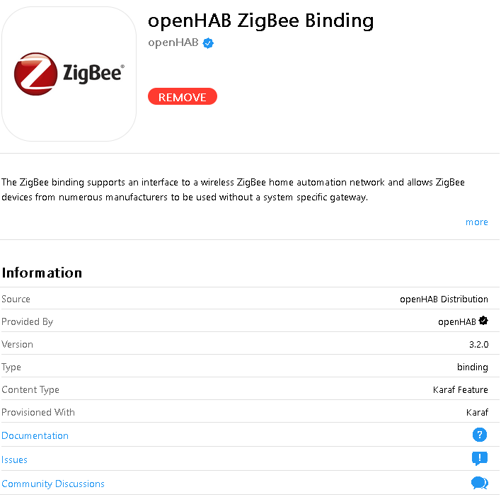

I installed it via the UI, and if I go to Settings, Bindings, openHAB ZigBee Binding, I see this:
So I believe it is up to date, but maybe there is something else to check.
