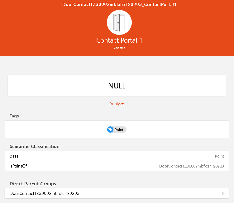

And I have linked the “Contact portal” to a Point item in my model.
However, that point item always stays NULL, even when I simulate an opened or closed state by moving the magnet away from the base sensor.

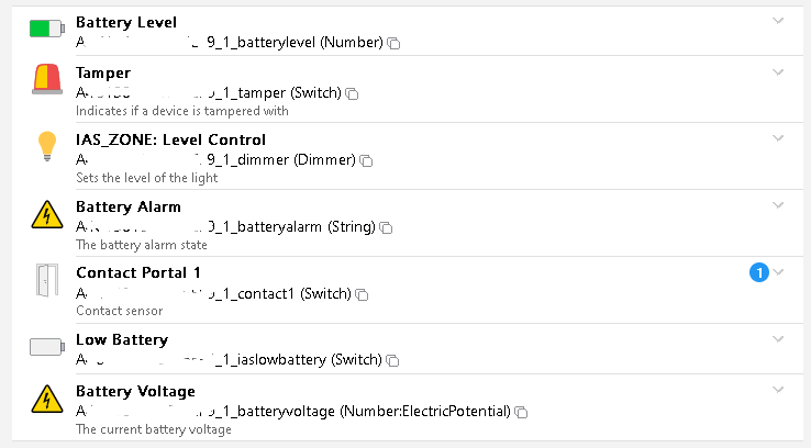

Well, I did not choose, I used the UI to “Create points from equipment” and selected “Contact Portal 1” as shown above. It used the “contact” type and created this:
But it’s the same with all the other channels on that device, they stay Null. I mean, if I create a point from the Battery Level channel, it creates it as Number but stays Null.
