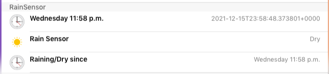

Hi, am demented trying to something which should be easy. Using an Aeotec door sensor which is wired to a rain sensor outside to show Raining or Dry in OH items & cards. I ALSO want to pick out timestamp when starts/stops raining.

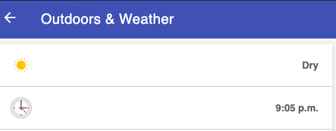

Easy peasy of course with old Basic UI Sitemap, works a dream - see screenshot.

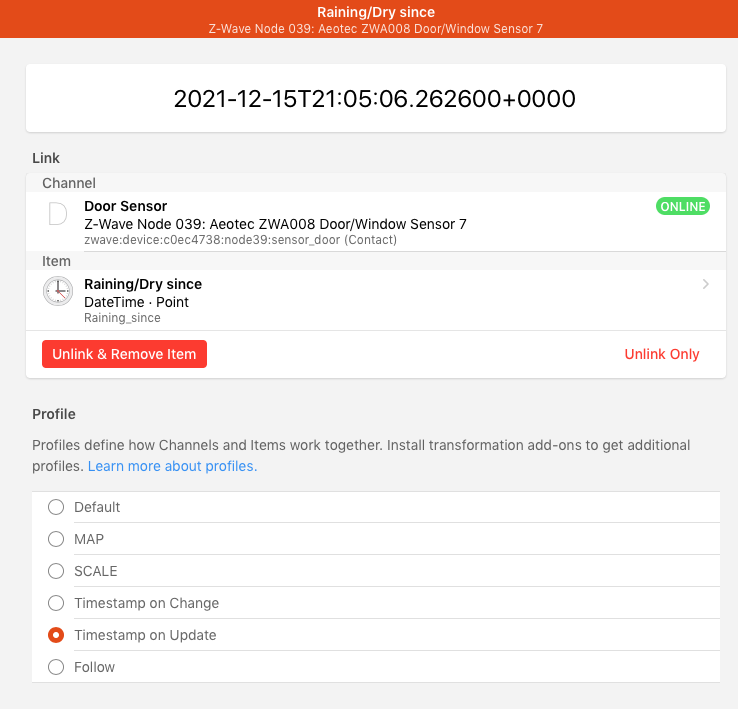

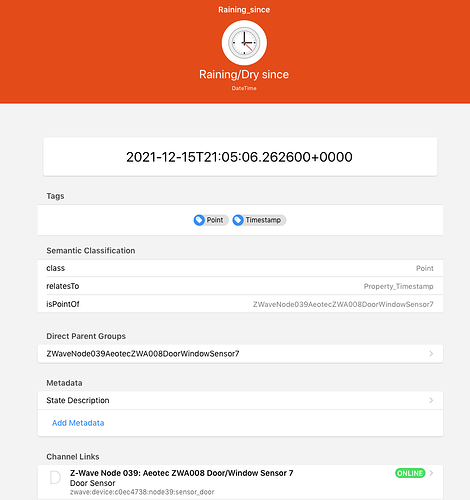

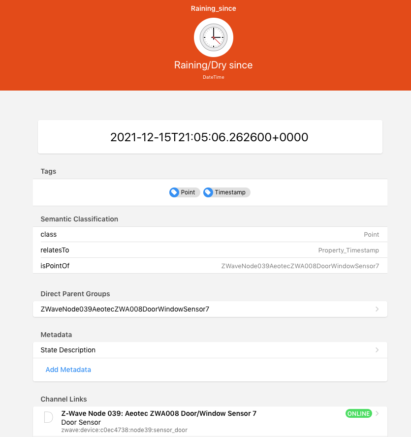

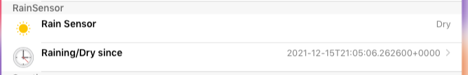

With OH3 UI the Rain/dry part works fine along with icon change etc. However, the long winded Timestamp version keeps showing stubbornly (although it does update ok). But I want a simpler display with just the hour & mins etc. I know what the pattern code should be and it works fine within Basic UI. For OH3 I created an additional DateTime Item and gave it a Timestamp-on-update profile and linked the normal Door close/open channel to it. Also I put a Pattern in the State Description metadata. Have refreshed the webpage and even relaunched OH. Am I doing something obviously stupid or what? Any help appreciated.
Basic UI setup
When you first apply the State Description metadata you often need to refresh the page to pick up the change. Since you’ve done that something else is going on.
Since it’s still not being picked up, you can force it if you configure a Default Standalone Widget and use =items["Raining_since"].displayState as the label. Do the same for the Default List Item Widget.

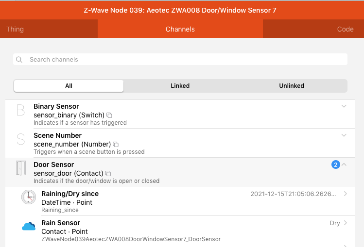

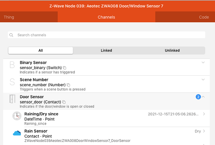

However, be aware that in most of the pages that you are showing will any of this apply. When looking at the Channels, the Link, and the list of Items in Settings->Items, and I think even in the model, only the raw state of the Item will be shown. It’s only in the widget at the top of the Item’s page, and in Pages that you will see the formatted states.
I’m guessing that last screen shot is from a Locations card so for sure there you’ll need to force it with a Default List Item Widget.
Hi Rich, I fiddled about creating another item with that label and using a Default List Item widget and linked it and then the original UI was formatting correctly but the new Item wasn’t.. I deleted stuff and have tried to recreate this but can’t..totally fuddled at this stage :crazy_face:..it’s barmy that something that was so simple and reliable to do in Basic UI + Sitemap has become so labyrinthine and totally fiddly in the new OH
In the pic below, the Top item is the newer one and the lower item is the original one which had been stubborn.

Ok what I should have said was the original Item and my effort to get it to display properly did now work (see lower item in the screen pic) whereas the new item/widget had the Timestamp as its label and the raw unformatted data as its display value.

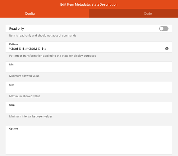

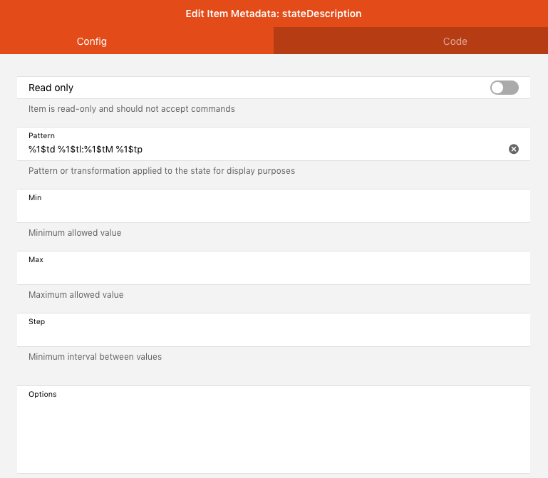

While I have the two of you attention (Rich or Rossko), can either of you please post exactly what I’m suppose to type into the state description please.
here is old OH2 item
DateTime MyCivilDawn "Civil dawn start [%1$tl:%1$tM %1$tp]" <none> (gHome)
Do I use square brackets? single quotes? double quotes? or just
%1$tl:%1$tM %1$tp

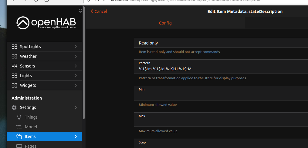

I’m the last person to give any advice, especially with the forum heavyweights lurking, but I did stumble on a DateTime format that works for me.

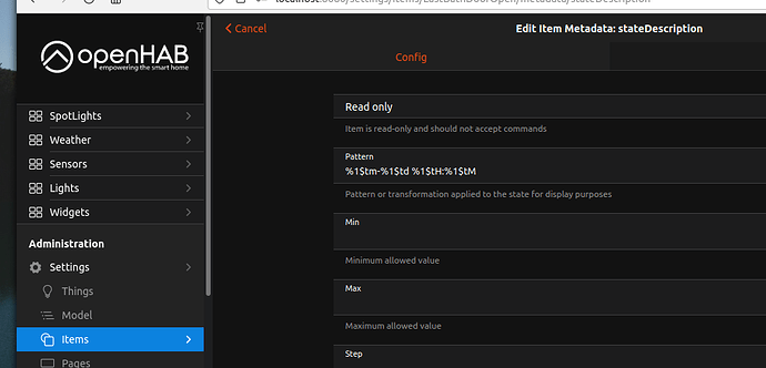

%1$tm-%1$td %1$tH:%1$tM

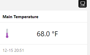

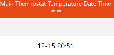

It produces this on a UI page.
The same on a widget;

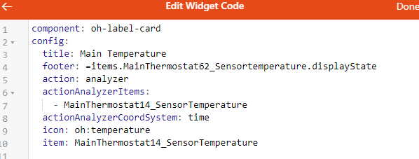

datetime format2
And lastly the widget yaml.
I like the idea of the month and date spelled out like some of y’all have had, but the above is literally all I know and it is mostly readable, so it is all I use.

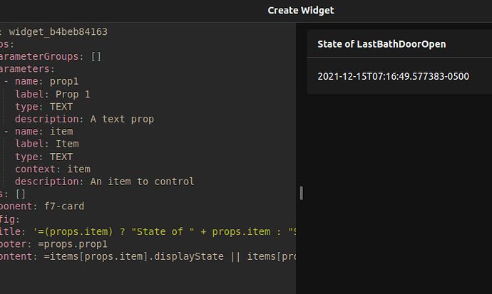

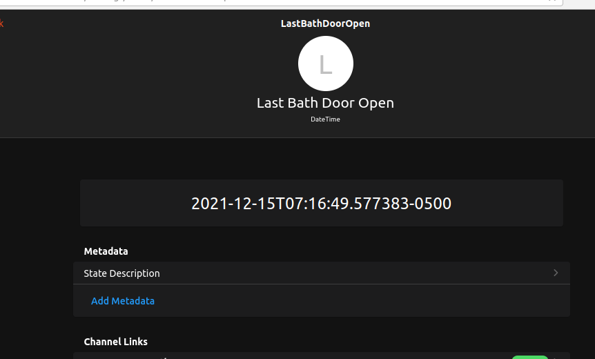

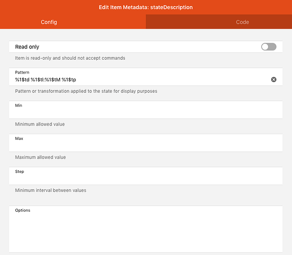

No, thanks for jumping in Bob, I think this might be a buggy, I’ve been trying for way to long to get this. Here is your format in my item
here is resulting item
What I’m I doing wrong???
Hi Andrew, you’re doing exactly the same process as me, the pattern looks fine and neither of us can get this (stupid) thing to work. :rage:

Just as you posted it. No square brackets, no quotes.

FWIW- I get the display state on the UI page for the item, but as you noted, not on the summary item page.

As shown in the screen shot below from a card display that I sent you last night, I didn’t go creating any new standalone widgets on a separate Pages setup. All I did was fiddle about randomly creating another item and adding a Metadata widget to it and messing with linking and unlinking.. is this what you meant by adding Oh-stanalone widgets etc last night? Somehow mysteriously it worked (see screen shot) but I took it apart and haven’t been able to reproduce the temporary success since :grimacing: so there would’t be any YAML code available to me would there? Well I don’t see any option to view the code when I’m dealing with a Metadata pre-made widget. I only see the option to view YAML code when I experiment with Widgets in Pages layout rather than the normal UI location/equipment/properties cards. If one can do this, I don’t know how, sorry. So I’m not trying to be uncooperative and I can see you’re genuinely trying to help but we all seem to be stuck in a web of frustration..
Pattern stuff DOES normally work for the cards but there seems to an issue here where the Profile of Timestamp on the channel is stubbornly overriding & ignoring what the user really wants to see from having inserted a Pattern to present the raw data in the desired way. This is the nub of the problem.
